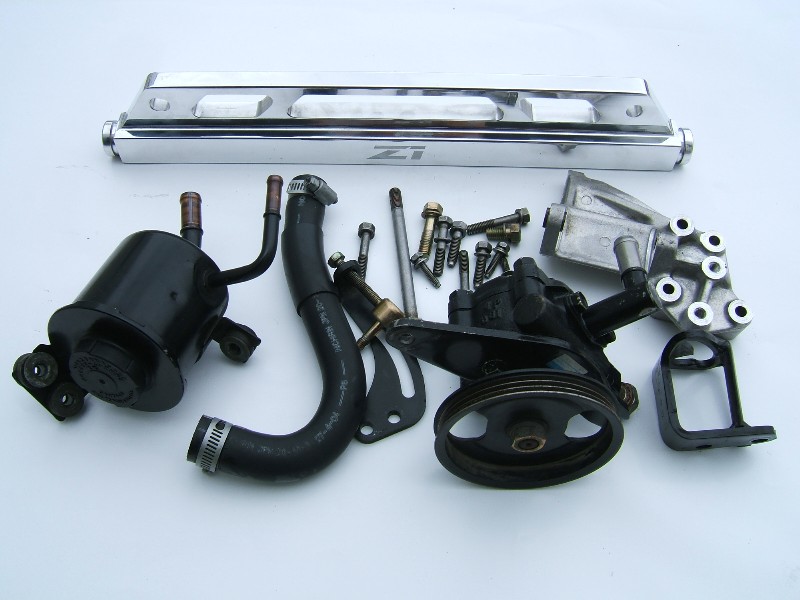

I have just dropped a TT lump in my car and gone to bolt up the original N/A pump to the mounting that came with the engine and it doesn't fit.......?
The N/A pump is too wide to sit in the gap where it bolts up to.....SDC10868.jpg

You need to swap the na bracket over
Time to go through the boxes and pray I didn't just bin it with a load of bits last week...........dohhhh
Thanks Baz..... I didn't think they would be different....lol
Sure I have an NA bracket in the garage if you get stuck.
Hi Baz and Olliezx, I managed to find the bracket after an hour or so searching boxes, then spent another hour looking for the long bolt then another 30 mins looking for the adjuster bar......
Finally got it all together to find the pulley is a 3 rib belt and the main pulley is 4 rib.... I decided to use a 3 rib belt...... I hope it sits and runs okay.......lol
