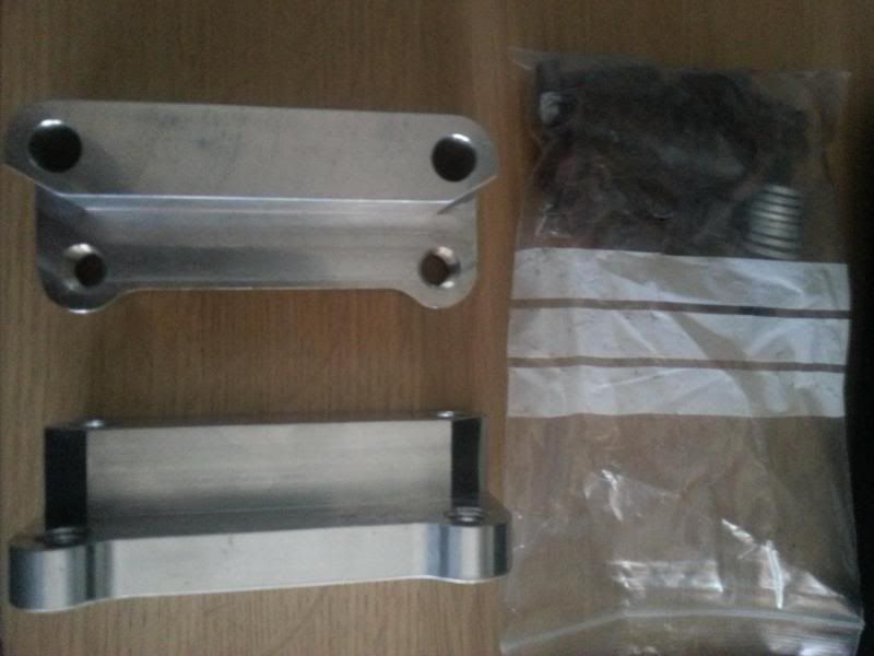

Bought these caliper relocation brackets years ago and just wondered what discs they fit?
They are marked as 324mm but would these be for gtr33 brake discs or 350z discs or does it not matter?

Hi Paul!
Got a text from Lee saying you were looking to get in touch with me (Thanks Lee :) )
I can confirm that the caliper relocation brackets you've got there are to be used with the 324 x 30mm discs which are commonly found on the R33GTR. DBA do some excellent discs in this size (check out Clark Motorsport). These are the same as the 350Z uses at the front. I'm pretty sure the 350Z was specced with either red or gold brembo calipers, the latter using a bigger disc. I'm afraid I've been out of this market too long to remember so you'd need to check with the disc supplier to be sure you're getting a 324x30mm disc.
