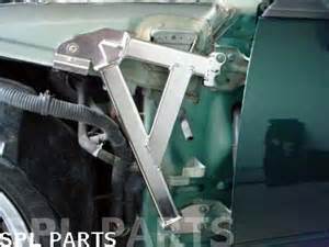

Not sure how this would affect the doors though, but they do sell a Front wing A-Frame that connects to the door hinges (?) so this might be a good option for you.

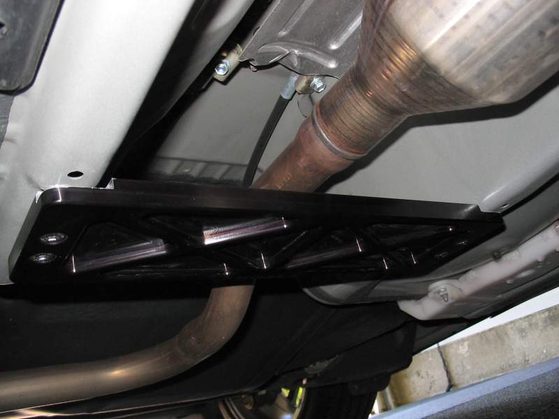

These are the frames that Olliezx is referring too, and one that fits across the tunnel.
