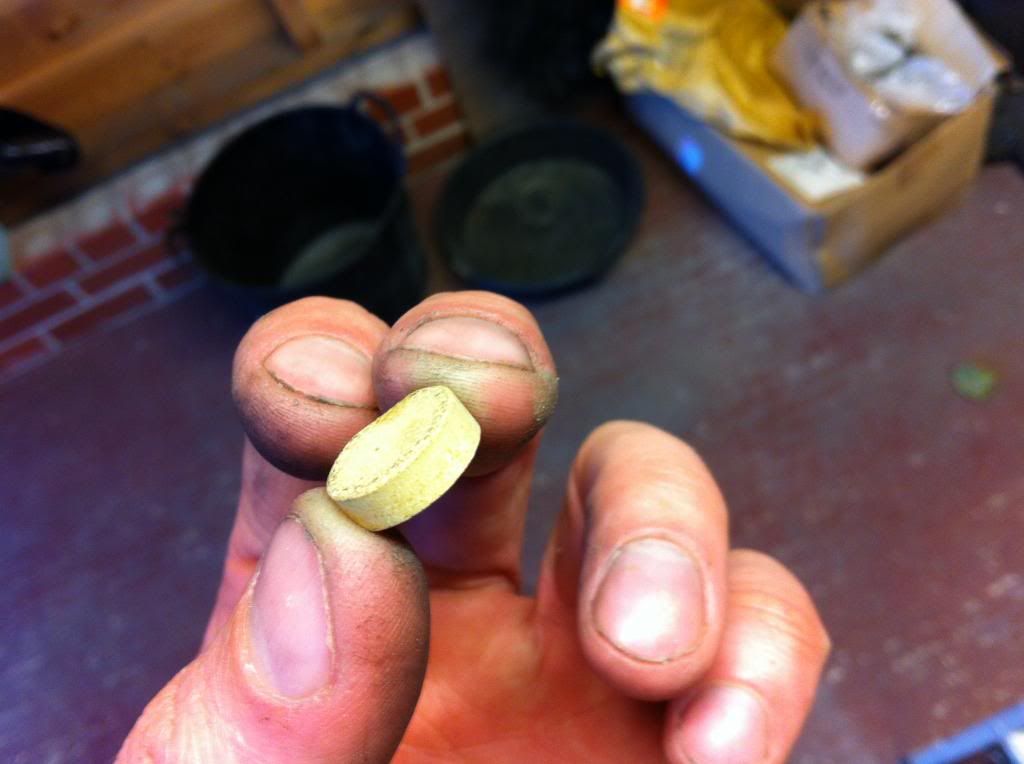

What are these?
I was cleaning my headlight earlier, heard a rattle inside and shook this out. Any idea what it's for or was my Zed used for smuggling heroin?
silicon tablets to repel moisture inside the housing and stop the lens steaming up, i got rid of mine and made no difference lol
If you have a condensation issue they are no longer working after all these years, silica gel sachets are pennies and work a treat, so slip one in the back so to speak !!
Oh and there was 3 in each unit and the black filter stuff that held them together has broken down over time and that's why they're now loose.
