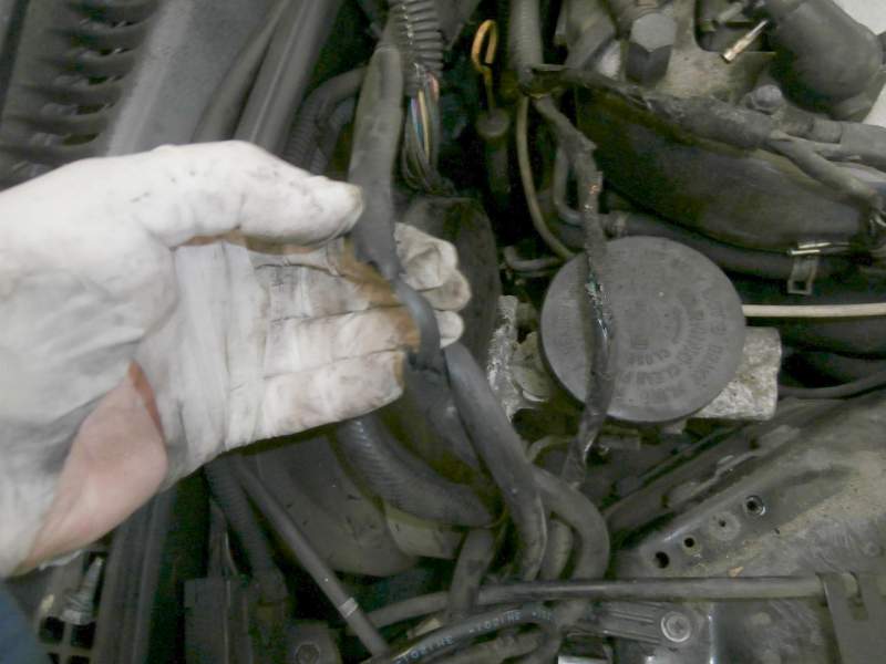

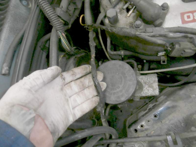

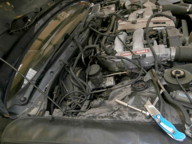

A case in point, we recovered this particular zed early last week, the engine fire had occurred at the end of an uneventful journey and whilst ticking over on turbo timer, lucky for the owner he was alerted to the problem and the prompt dispatching of a fire extinguisher saved there been too much damage.

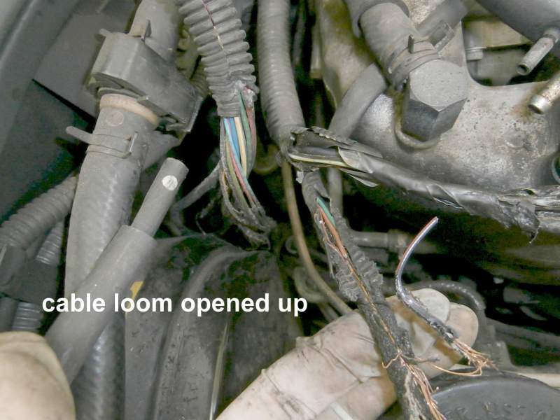

We picked apart the damage to see what we could salvage in the area of the fire, as the cables and vacuum pipes were removed and /or pealed back we replaced as we went along.

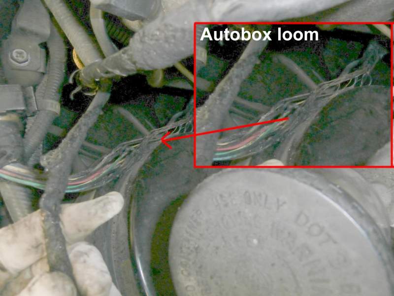

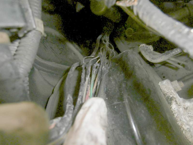

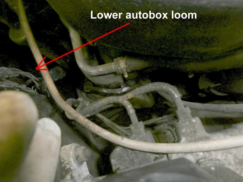

So eventually the source of the issue is revealed...the auto-box loom? and odd one for sure as the fuse for the autobox had clearly gone as a result of the shorting cables. So quite why it actually ignited into full on flames is unknown, no oil or fuel in the area, just purely the cable loom brittleness and dryness came together at that point of short ( against the engine block) and ignited, the owner reported full flames... very scary.
Now we currently are writting a report for the insurance company as per usual they are trying their level best to not pay out???
