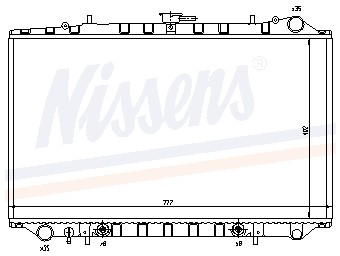

We do not have any non turbo radiators in stock at the moment either, however the non turbo auto radiator is possibly same as the 1989 - 1994 Nissan Maxima J30 check out the spec on the following ebay listing, the dimensions are all there, it certainly looks the same.
Item number:310439317640
Jeff TT
RADIATOR - NISSAN MAXIMA 1989-1994 62980
TECHNICAL INFO :
RADIATOR : - NISSENS 62980
CORE DIMENSIONS 402 X 717 X 25 MM NISSAN 2146085E00
MATERIAL COPPER VALEO 731134
MATERIAL PLASTIC
TRANSMISSION TYPE AUTOMATIC TRANSMISSION
VEHICLE EQUIPMENT FOR VEHICLES WITH OR WITHOUT AIR CONDITIONING
