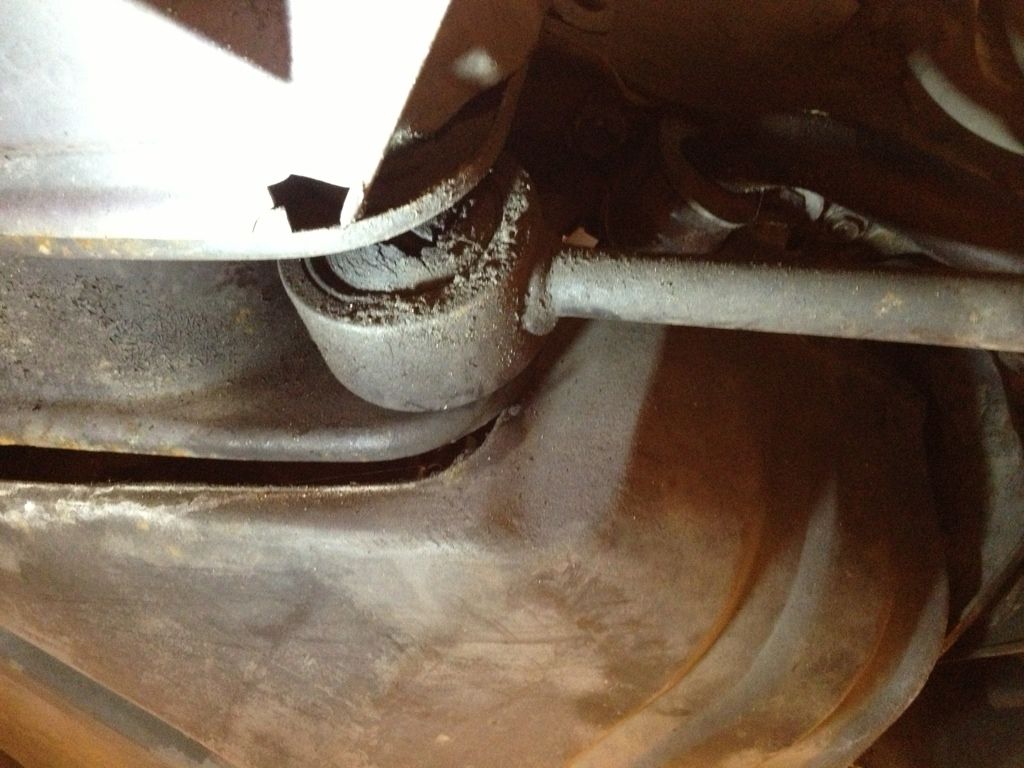

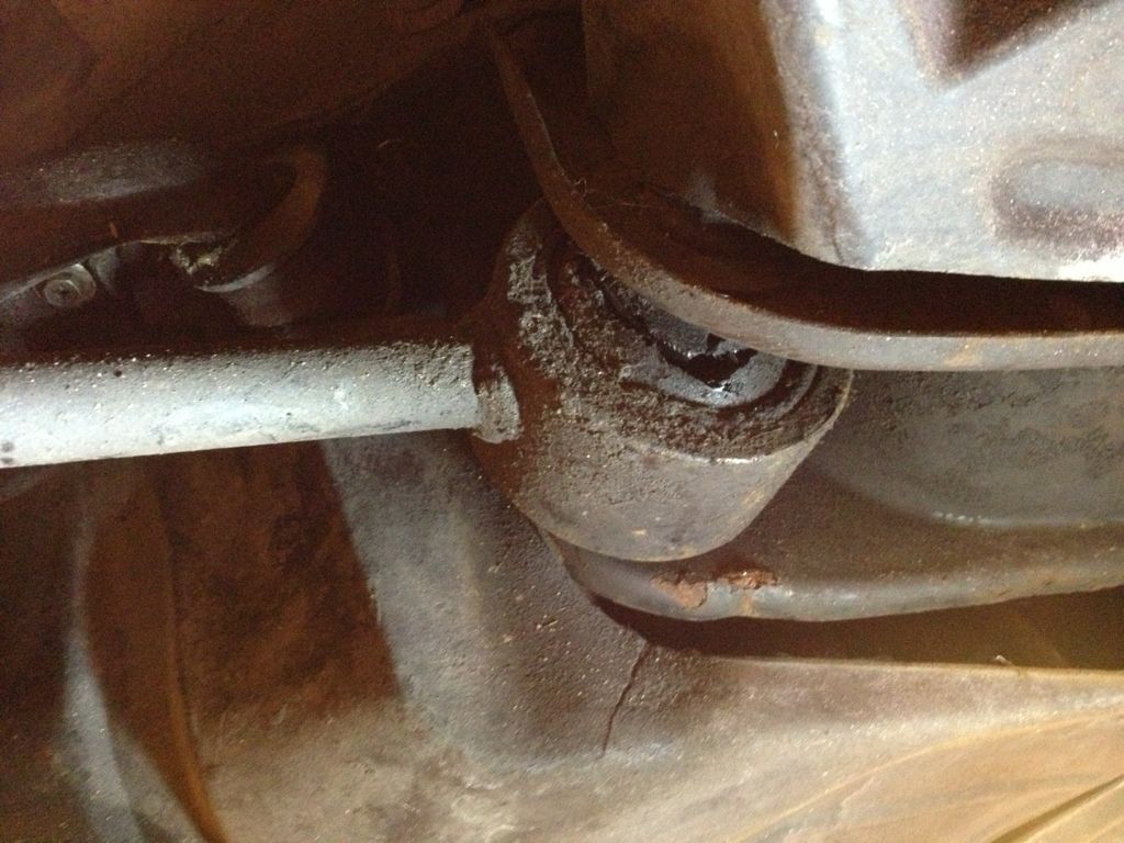

Bush worn but not sure name of part lol
Hi, wonder is anyone can help please.
My dads car went for MOT on Monday and it was noticed 2 bushes are really bad (pics below) ive been told they are the front lower control arm bush but am i right in thinking its the front tension arm? Also where can i buy replacement bushes?
Thanks :D
pretty sure you cant get those bushes seperately.
Its new arms for standard or Nismo/aftermarket poly bushes etc or adjustable tension rods with rose joints installed as options IIRC
You can get poly bushes for them, easy to fit as well. There used to be a fault with the early ES ones, they were to hard and didn't have enough give in them. The result was a torn mounting where the arm bolts onto the cross member. Not an issue now though.
