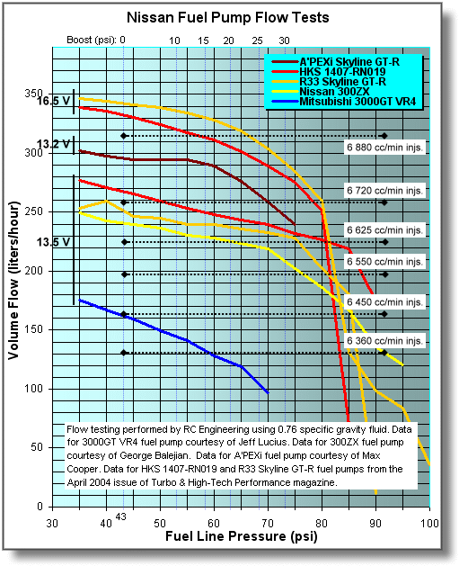

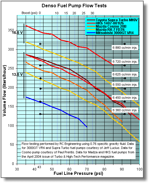

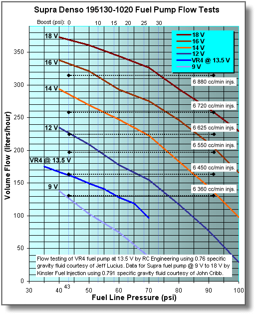

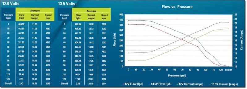

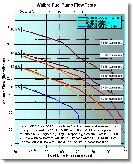

if the Base Fuel pressure is 43psi .. and the regulators Pressure up 1 psi per 1 psi of boost .. so would i be right in saying that if my engine was boosting at positive 20psi that means
the fuel pressure rate will be some where 63psi and so on depending on the max boost being ran
so i need to be looking at the pump to see what gives me the most flow at the max Pressure/boost i will be using ?
Edited by MarkDerby
yes ..
strange how when i searched fuel pump it never came up ...
Stock nissan ?
Walbro 255
Bosh 044
Aeromotive
detchworks 300/320
Walbro GST 400
Walbro GST 450
cheers for that ..
still looks like the 400>450 will be more than i need
for the fuel pressure of 40>70psi to have the correct flow as well
