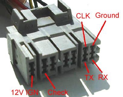

Seriously.... Diagnostic check, no guessing required :)

IGN on
Bridge the 12V ign & Check pins
Remove bridge
Count flashes of engine check light on dash
Re-bridge to clear fault codes
Ahhh see what you mean thanks mate, will try that tomorrow. Btw where abouts is the ecu on them?
