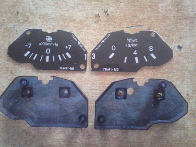

Just to update this thread for future reference these are my Jap series 4 faces and are completely different from the ones posted above. I butchered the speedo face a while ago as of course it shouldn't be like this. Pictured alongside my bespoke made glo dials which were based on the ones above, so no wonder I had issues fitting but I sorted it all :yes:.
Please note how the boost and oil gauge fit inside the blue 'trays', is it only S4 that as this then ? To fit my new faces I cut away the raised edges and made them flat.
Right a further update after further testing in the darkness, you will of noticed above the blue 'trays' as I call them with the edges, well I used a pair with chopped off edges, ie flat, as you'll notice the indiglos I wrongly got are too large and so needed a flat surface to overhang.
But there was a problem with this method, once fit these two small gauges were swamped with light from the stock T10 bulbs which you need to keep for the needle illumination, note glo dials do not need any illumination from these stock bulbs as of course they have their own built in EL display.
So, I chopped down the new white glo faces as you can trim them in the right places, so that they fit practically in these trays, I just had to cut off part of a tray edge where the two wires were, the blue trays were also brush painted in craft black paint to allow no light in whatsoever.
The result is much better as all you want to see is the glo dials lit with lovely red needles spinning :thumbup1:.
