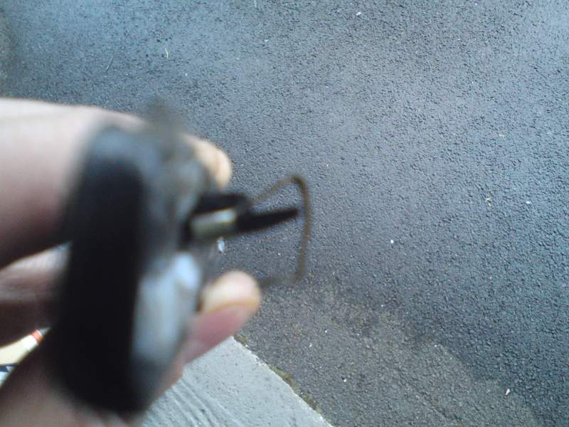

Having put my radio console back in today and in 3.5 years of ownership I could never just get right this center long screw cover strip, the previous owner/s have attached velcro and another one I have here as some blue tack on it of all things :thumbdown:.
Now all it needs is the clips which you see in the first pic bending, so this is wrong and sprained - what you don't want, this'll lead to the cover not fitting flush enough to the console.
You cannot bend them back in situ so just tease up the claws that hold them on and slide the clips off, put a pair of pliers on the claw end and just bend with your fingers until they are back straight or even a touch the other way, then just slide back on and you'll end up with this, and I do know I have a metal clip missing - this is my spare !!
It's all in the detail and you'll now find the the screw cover will fit like it should :yes:.
