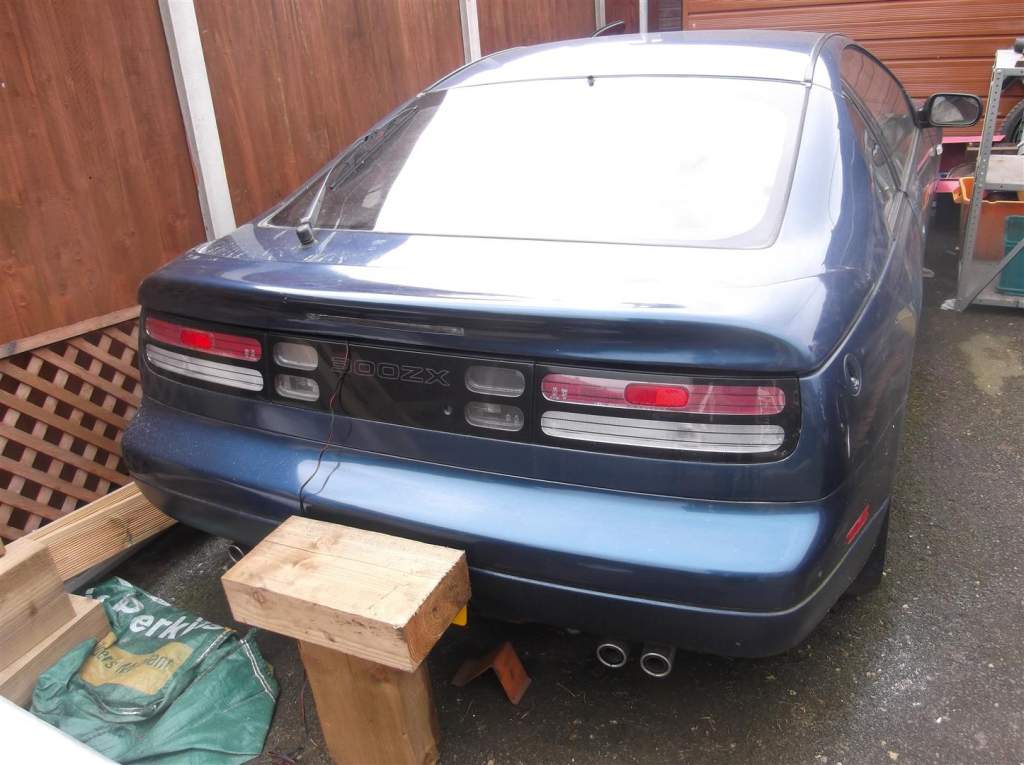

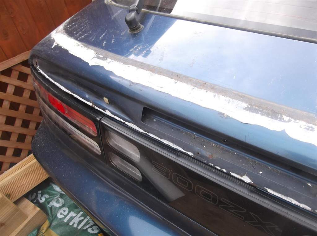

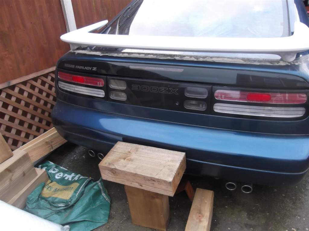

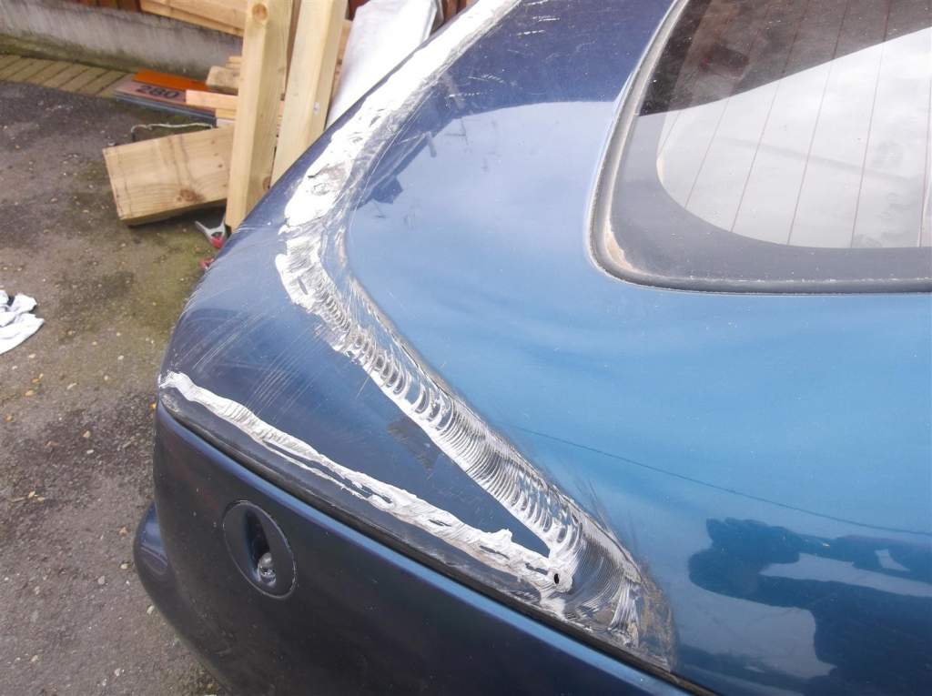

Today I made a start removing the tailgate skin than was fitted to my spare slicktop when I bought it.
A nice surprise under it.... NON rusty metal.
Some of the square holes to fit the perspex strip pegs are not drilled but that can be fixed.
Trial fitted srip without them.
I also got the horseshoe style 95 OEM spoiler out of the loft so I can get that fitted.
Will put tailgate skin up for sale if anyone wants it.
