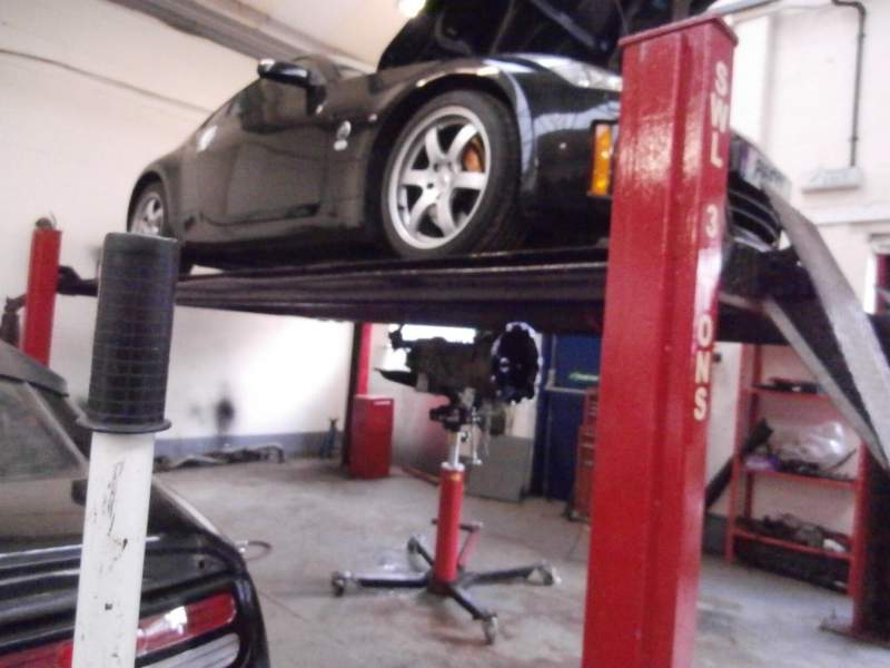

Case in point yes a 350z I know but at least its a z so moving on, having had a new clutch fitted 2 months previous by one of the High street clutch specialists the owner thought her big spends were over for a while, however when changing the clutch the garage had recomended she had a new slave cylinder fitted, the cost been around £120 extra, the owner concidered it an extra cost they would rather not pay for so the box was fitted and all seemed well. Of course the clutch pedal failed in under 500 miles and was subsequently recovered from the M6 slip road at junction 9, been so close to us the AA dropped it outside with a note to explain.

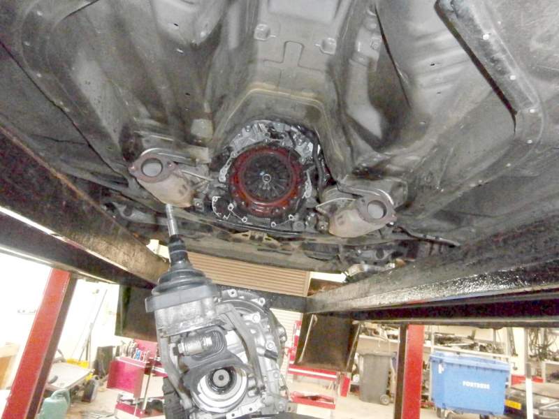

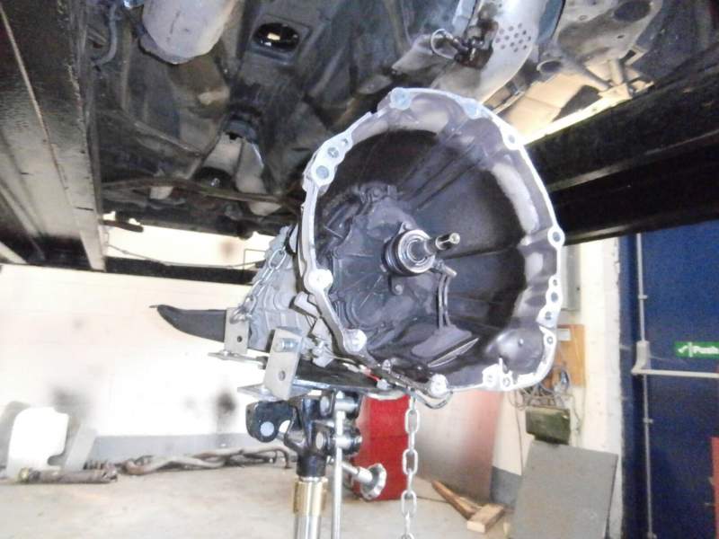

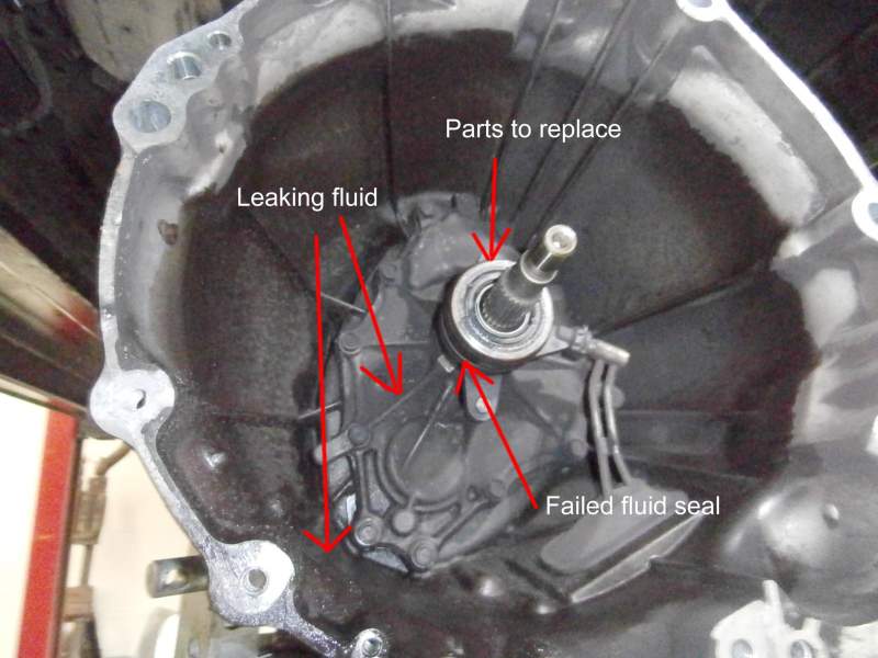

Now the savings are now lost as unfortunely for this owner on her particular year 350z the slave cylinder that had failed is the concentric type, and to those not in the know that means its on the gearbox mainshaft and required the box to be removed......again!
The good thing is the 350z gearbox comes out easily, with some clever clips and brackets making it a nice job, the slave cylinder was removed and was leaking a lot and no wonder there was no pedal.
