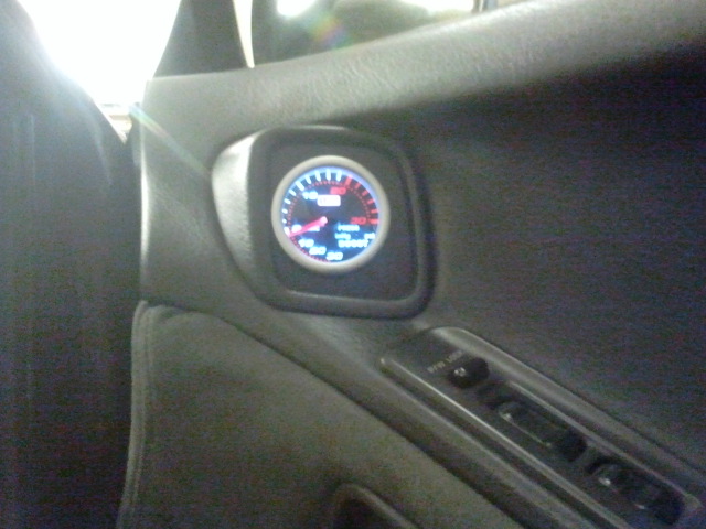

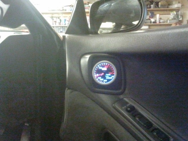

Boost gauge in door vent
as above..the most awkward part is getting the boost pipe through the cable trunking from car to door.Nice little mod without having another gauge pod on the dash or in the radio din slot:cool3:

Great work as usual mate :thumbup1:
How did you get round the possible kinking of the vac line?
Nice soft rubber vac pipe Dave and keep all the radius curves nice and slack...in the door clipped to the back of the speaker plate and after another gentle radius into back of gauge.
