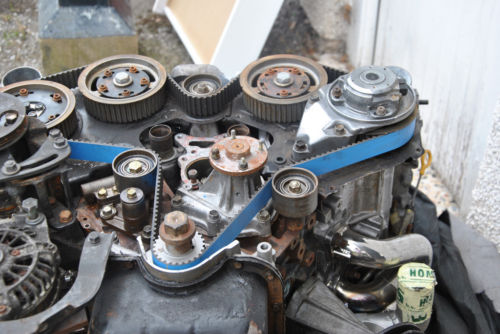

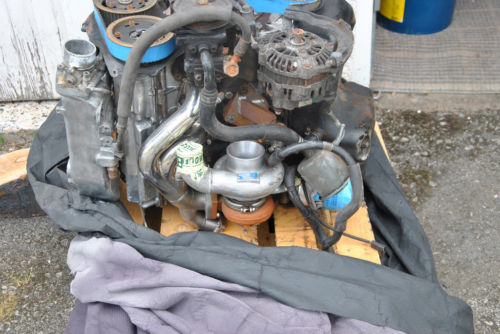

It came with forged internals, Wiseco pistons, Eagle rods, ACL Duralite white metal bearings ARP main con rods and head bolts, Tomie 260 degree camshafts with solid lifters & harder springs, SARD 850cc injectors with a Border fuel rails/ new Turbo's, s/steel manifolds, new oil pump, heads polished, exhausts ports and valves shimed & lapped.
Didn't look all that great mind when it finally arrived to be honest, and I still had my doubts as to whether I had done the right thing in buying this.

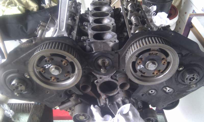

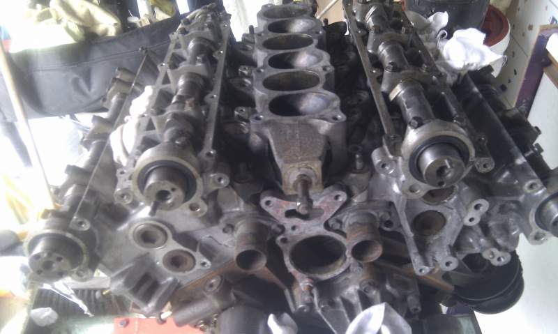

After stripping down the engine as far I was prepared to take it anyway,
I wasn't going to attempt to go much further, soI thought it would be best to get this done properly!

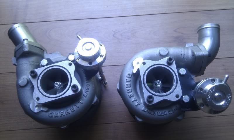

Garrett 300ZX GT2871R Ball Bearing Turbo Kit (800HP) .86 A/R w/ Forge Actuators, Blue Spring

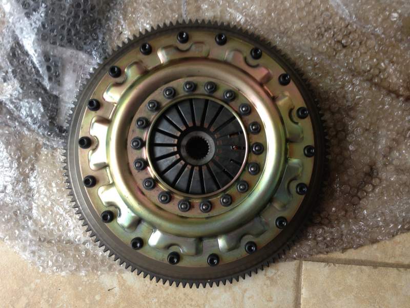

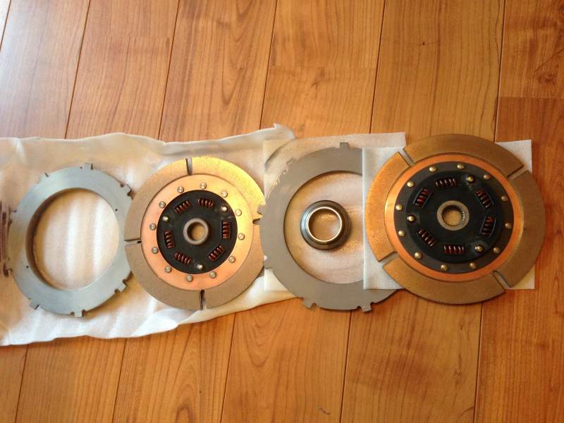

My new clutch arrived yesterday :thumbup1:
