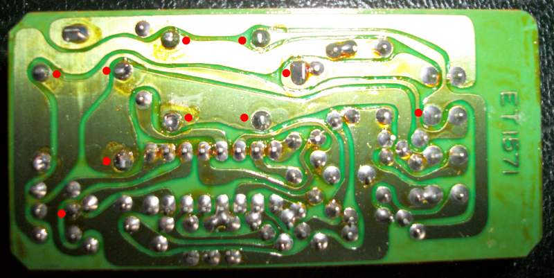

Right, I've taken the amp apart and found a few dull joints. It's very hard to tell on the pic but all the ones marked with a red dot are dull when compared to the other joints.
Next job is to re-heat the dull ones and see if that fixes the problem.
It's the picture Mark, when you look at them straight on in normal light they are a dull grey.
