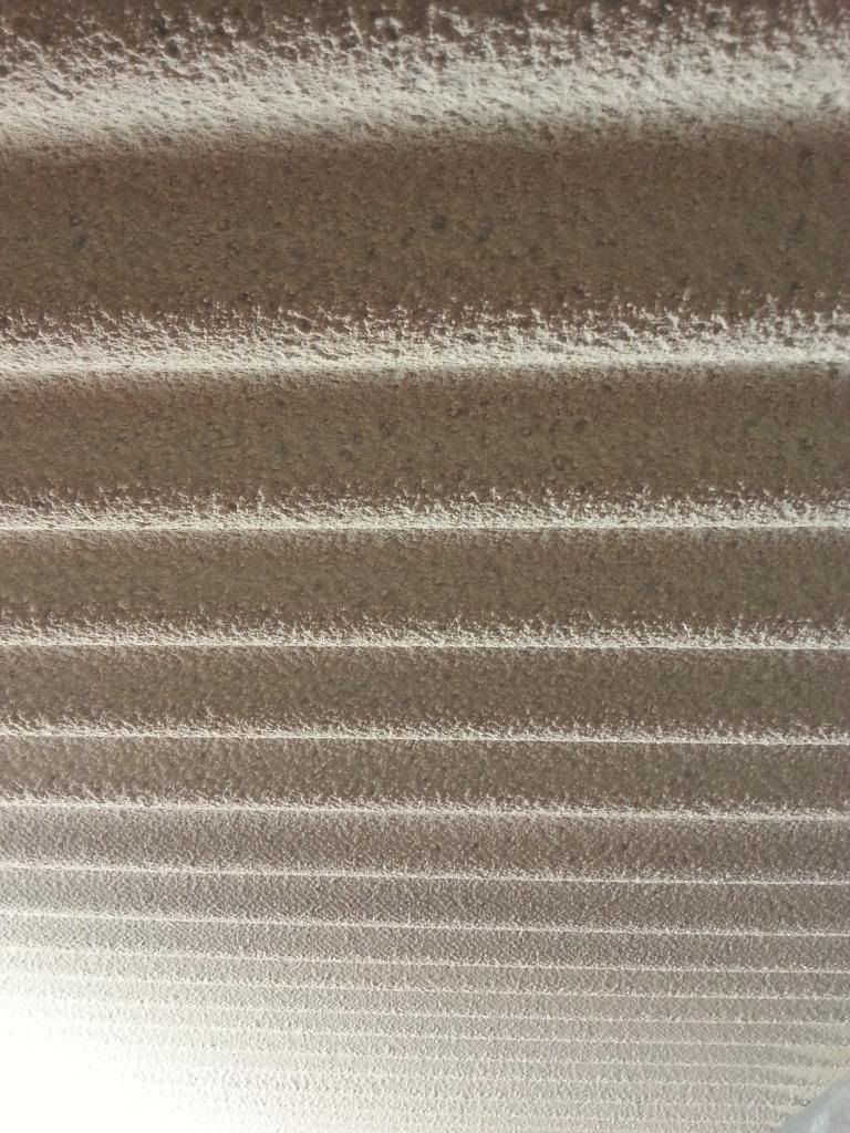

I have one of them concrete garages, and they have a metal corrugated roof. When getting installed they put this sheeting underneath to stop condensation. Heres some pics. Ive never had any condensation problems yet touch wood. Not sure what its called tho.

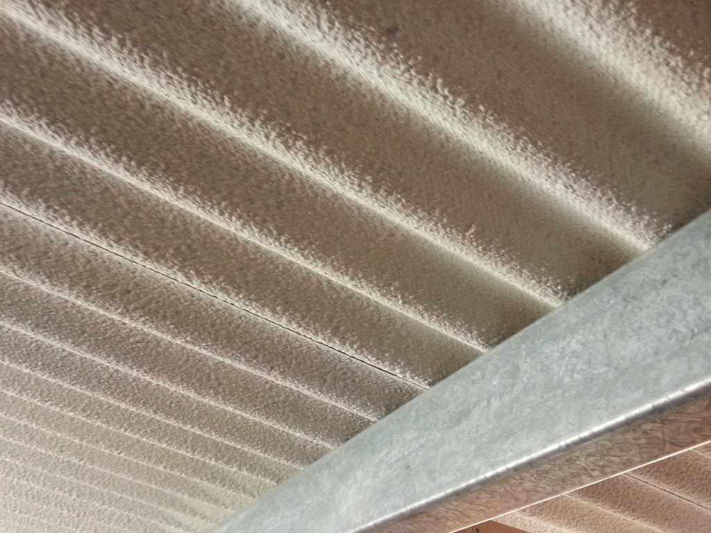

Been building my workshop for the last 18 months, and finally put the steel roof on in August. Pitched roof with steel z purlins going gable to gable means I have a completely open attic void with no trusses in the way. Lots of storage!
Anyway I researched insulation options quite extensively. Apparently difference of around 1-2 degrees between the inside air and the outside will cause condensation.
You have several options which I'll list worst to best:
1) EPS sheet cut to fit
Will work BUT will be flush against the valley on the corrugated sheet. This means the crest of the sheet is forming a void above the eps panel. Air will get in there either from inside or outside and it will still condensate. If it gets really bad it'll drip down onto the eps and run down until it find an exit. Every joint needs to be taped to stop the air going up through to the roof sheet.
The other major issue is fire - even the fire retardant stuff burns real bad. An angle grinder spark will just go straight through it.
2)
Foil backed Kingspan style stuff
Easier to work with than the EPS, better fire ratings too. Foil backing means that you can tape the joints much easier and effectively and in doing so you form a 'vapour barrier.' Very expensive though
3)
DIY sprayfoam
Very effective - it will get into every gap in the roof and seal it. It's 'closed-cell' foam meaning it is waterproof. You will end up with a well insulated warm roof.
It looks easy to apply but I bet its not! :)
Bad news - diy spray foam kits have no fire rating! The stuff you see online that says this and that about fire actually refers to a German B1 rating which is basically means it will combust/ignite
4)
Contractor installed sprayfoam
Get a pro in and you can have british standard class 0 fire rated foam. Hold a blow lamp on and it'll melt but not catch fire.
Cost is not exactly cheap - I've had quotes for 60m2 at 50mm thick range from £1300 - £2500. They all tell me they would have my roof done in 1/2 a day.
Funny angle photo of my roof below
