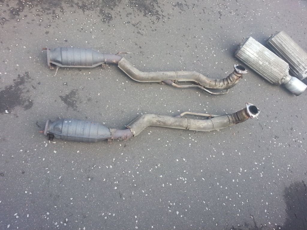

This is the cats (sitting the opposite sides from how they should)
then these two sections before the backboxes
If either of these will sort your problem then they're yours.
