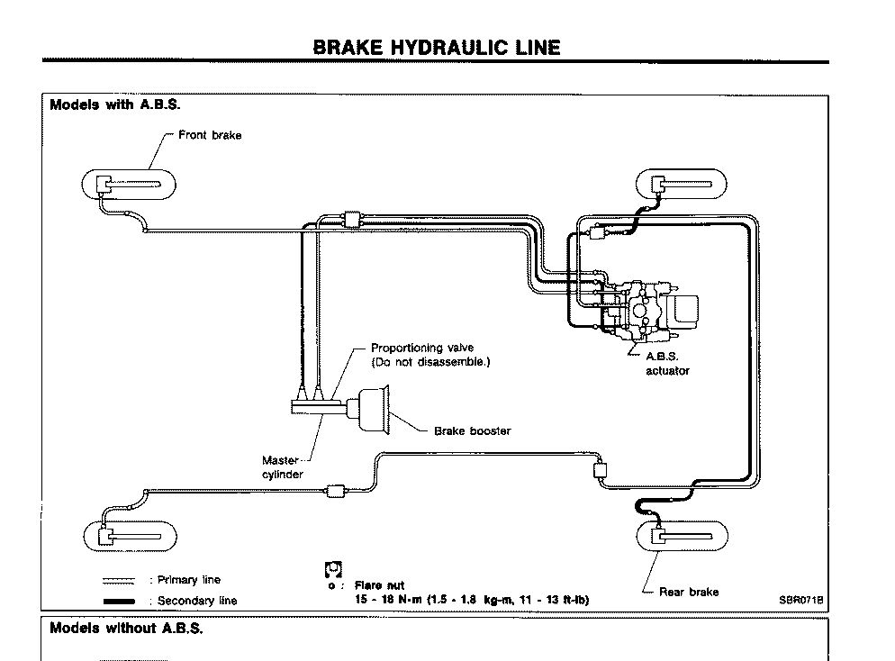

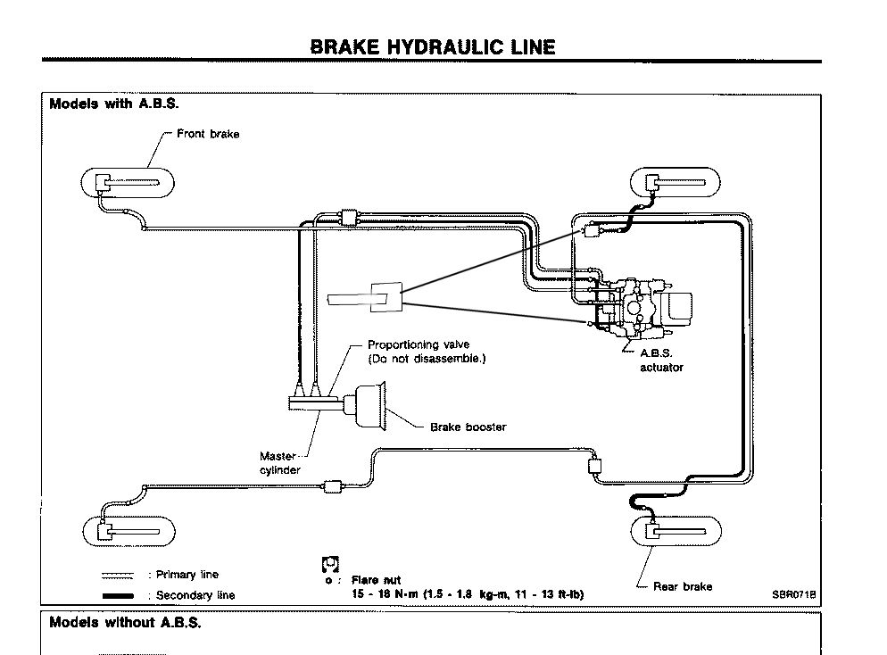

fitted a racing seat from my old s13 and stated to fit the s13's hydraulic handbrake, but just want to know if im plumbing it right?
