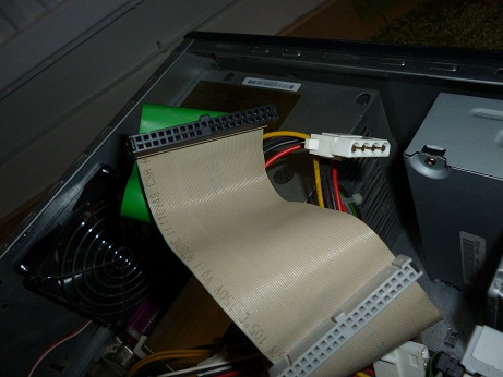

Top left is a picture of the cables that were in the back of my old dvd burner.

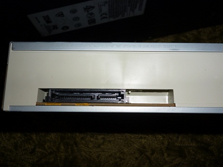

Top right is the back of my new dvd burner (tthat the old cables wont fit into)

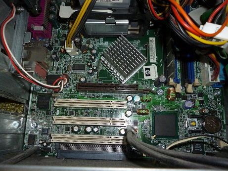

Bottom left is the inside of my pc

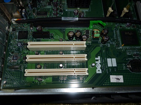

Bottom right is another pc I could install it into if I needed a different motherboard etc)

your burner is Sata but your system is IDE only
you have 2 options
Build a new pc or buy an IDE dvd burner
Sorry Scrap that i see two Sata ports there just left of the cmos batt
get your self a Sata Lead and a 4pin molex connector to sata power

Can you let me know where they go? Bottom left PC or bottom right PC ? (the bottom left is the one I would rather use but dont have too)
thats easy
there are 2 small black plugs left of the cmos bat ( watch bat ) thats the silver round thing on the left in left pic
the Red new lead will plug in to one of them then gos to the smaller right socket on the dvd burner in right pic
the Gender change lead with the 4 pin white plug will just plug in to a free power plug and then to the
larger left socket on the dvd burner in right pic
