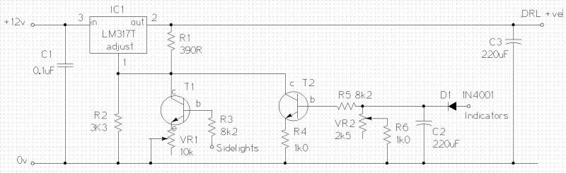

OK here is the circuit diagram for anyone interested in trying this at home :biggrin:
Components required (inc Maplin stock codes)
R1 - 390 ohm - Orange White Brown (or Orange White Black Black) M390R
R2 - 3.3k ohm - Orange Orange Red (or Orange Orange Black Brown) Maplin: M3K3
R3, R5 - 8.2k ohm - Grey Red Red (or Grey Red Black Brown) Maplin: M8K2
R4 - 1k ohm - Brown Black Red (or Brown Black Black Brown) Maplin: M1K0
VR1 - 10k Variable Preset Resistor. Maplin UH16S
VR2 - 2.5k Variable Preset Resistor. Maplin N51BR
C1 - 0.1uF Capacitor (16V or greater) Maplin N43CJ
C2, C3 - 220uF Capacitor (16V or greater) VH24V or DT64U
D1 - Diode 1N4007 Maplin QL79L
T1, T2 - BC547 Transistor Maplin: QQ14Q or BC549 Maplin QQ15R
IC1 - LM317T Variable voltage regulator Maplin: UF27E
A bit more about the components
I built this using various bits I had lying around and most of the components are not that critical.
However the values of the resistors are fairly important so use the ones I specified if possible. Resistors can be connected either way round
Capacitor C1 could be pretty much any capacitor from about 0.1uF to 1uF (and rated 16V or higher) and could probably be left out all together.
C3 could be any capacitor from about 10uF upwards (and rated 16V or higher) and again could probably be left out with no ill effects.
C2 value is fairly critical to the circuit design so use a 220uF one rated 16V or higher
C2 and C3 are 'electrolytic' capacitors - this means they will only work one way round. The curved plate on the circuit diagram is the negative one.
D1 could be pretty much any rectifier diode, eg 1N4001, 1N4002 etc. Diodes only work one way round. The end with the 'stripe' is usually the end that the arrow points to on the diode symbol seen on the circuit diagram
T1 and T2 could be pretty much any general purpose NPN transistor (for example BC107, BC108, BC549, 2N2222 or BC337 like I used). Transistors have three 'legs' called collector base and emitter (shown as e,b,c on the circuit diagram) and these must be connected correctly
The LM317T voltage regulator also has three legs called 'in' 'out' and 'adjust' and must be connected the right way round. These regulators are made by a number of different manufacturers so the pin numbers may not match the ones in my diagram - so just take a little care you get it fitted the correct way. You need a 1.5Amp regulator - that is the one with a T at the end, not for example LM317L which will not handle sufficient current for this circuit. The Maplin one (code UF27E) has the same pin numbers as the one I used.
The Variable Resistors VR1 and VR2 have three legs but we only need to connect to the middle leg and one of the end legs (either end it does not matter)
Total cost of the components from Maplin, who are by no means the cheapest is £5.96 for each controller. That excludes the cost of the strip board I used to build the controllers on (about £4 and I have plenty left over), and the small boxes I put them into (Maplin: LH20W £3.69 each).
Total should be around £20 for the two controllers - and you will probably be able to buy the parts needed much cheaper on ebay - I did!!
My DRLs are fitted 6 each side of the car and draw about 0.5 Amps per side. The LM317T handles this without a heatsink - if your DRLs draw much more than 1 amp per side the LM317T will get pretty warm so will need keeping cool by bolting a metal heatsink to it! If you have DRLs that draw a lot more power than 1amp ask me and I will give you an upgraded version of the circuit.
How it works
Refer to the circuit diagram below:
The LM317T variable voltage regulator controls the voltage supplied to the DRLs. The higher the voltage the brighter they are. The voltage comes in on pin 3 (12volt supply) and comes out on pin 2 (variable voltage)
The Voltage supplied to the DRLs via pin 2 depends on the values of the two resistors R1 and R2. connected to pin 1.
The values of 390R/3k3 will supply 12Volts so the DRLs are on full brightness
If you were to reduce the value of R2 then the voltage feeding the DRLs would decrease and they would dim.
The transistors T1 and T2 act like electronic switches (or relays). When there is no voltage on the base connection they are switched off and have no effect on the LM317T voltage regulator.
Now imagine you turn on the sidelights. This will put a 12V supply, via resistor R3, onto the base of Transistor T1. This causes T1 to turn on. R3 is there to limit the current supplied to T1 to a safe amount.
When transistor T1 is turned on, it's just like turning on a relay connected between the 'c' and 'e' connections of the transistor. This connects VR1 across R3 and so reduces the resistance value. This causes the voltage supplied by the LM317T to reduce and the DRLs to dim. You can adjust the variable resistor VR1 to set the dimmed brightness level
When you turn off your sidelights, transistor T1 turns back off and the DRLs go back to full brightness. Remember I said T1 is acting like an relay? That is perfectly true - and you could replace the transistor with a relay with the coil powered from your sidelights, and the contacts connecting VR1 across R2 and it would work just the same! But a transistor is a few pence, a relay is...... rather more and goes 'click'
OK so that's how the dim function works.
Now imagine you turn on your indicators. Ignoring the components C2, R6 and VR2 for the moment you see that everytime the indicator flashes on, you will supply 12V via the diode D1 and resistor R5 to the base of the transistor T2. This turns the transistor on and effectively connects the 1k resistor R4 across R2. This causes the combined resistance (R4/R2) to drop so much that the output voltage from the LM317 falls to about 3V. This is not enough voltage for the DRLs to light up, so they go out.
Now when the indicators flash off, the transistor T2 would turn off again, which would cause the DRLs to come back on. We would have the DRLs/Indicators flashing alternately Yellow/White/Yellow/White... which is not quite what we want.
This is where D1, C2, VR2 and R6 come in to play.
Capacitors used in this way act like little rechargeable batteries. When your indicator flashes on, the 12V supply flows through diode D1 and almost instantly charges C2 to full capacity. Yes the 12V from the indicators is also powering the base of T2, thus turning the transistor on and the DRLs off.
Now consider what happens when the indicators flash off. There is no more 12V supply coming from the indicator, so the capacitor C2 starts to discharge. It can't discharge back via the diode D1 and your indicator bulbs, as the diode only allows electric current to flow one way (the direction of the arrow on the symbol)
So the capacitor C2 discharges mostly via VR2 and R6 instead (and also via R5 and the base connection of transistor T2 keeping the transistor turned on).
VR2 sets the discharge rate. The lower you set the resistance of VR2 the faster C2 discharges.
If we set VR2 such that it takes more about a second for C2 to discharge and T2 to turn off (and the DRLs to come back on) then before the capacitor C2 can fully discharge, the indicators flash back on instantly charging it back up again. C2 can never fully discharge because everytime it gets down to about half charge the indicators flash back on and charge it up again. This keeps transistor T2 turned on and the DRLs turned off. Only when the indicators stop flashing can C2 finally discharge, T2 turns off and the DRLs come back on.
Adjust VR2 so that the DRLs stay off while the indicators are flashing, and take about a second to come back on afterwards
R6 is there to stop you setting the resistance of VR2 too low. If R6 was not there and you turned VR2 all the way over to one end then the value of VR2 would be around zero ohms so you would create a short circuit between the indicator supply and chassis, via D1.
Something would have to give, most likely D1 would explode in a slightly spectacular manner or VR2 would simply fry and burn! Because R6 is there this can't happen - the total resistance of VR2+R6 can only be adjusted between 1k and 3.5k
C1 and C3 don't do anything particularly interesting, they are there to filter out voltage spikes and surges which could otherwise cause the LM317T to become unstable and the brightness of the DRLs to fluctuate. In most cases they are pretty much redudant and everything would still function normally even if you removed them
So that's how it works, I hope my explanation is clear enough for anyone with only a basic knowledge of electronics to be able to understand my design.
Rich
