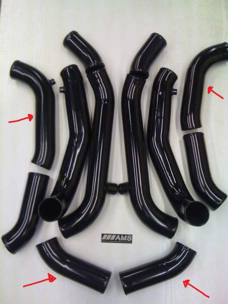

The red arrows show the pipes i have left over. The only decent diagram or pic on how the kit goes is this pic from ashspec.
No instuctions are availble so Ive fitted my kit as the pic and its all i can see that needs fitting.
P.s one of the spare pipes has a take off pipe that needs plumbing in to what ever its for.
Enjoy thanks Dan

bottom ones should be behind the intercoolers
top left/right should be from turbo outlet
PS that built up pic is wrong
Ok thanks Jaffa....The 2 ones that go behind the intercoolers they have also supplied silcone to do the same job i think then! Im guessing its for different type intercoolers.
As for the turbo outlet im sure that is a different kit you have to buy. What would the take off plumb in to?
Thanks Dan

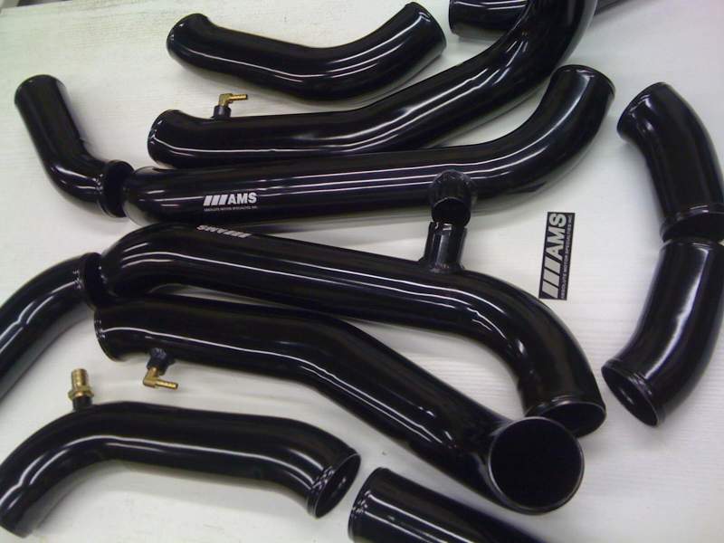

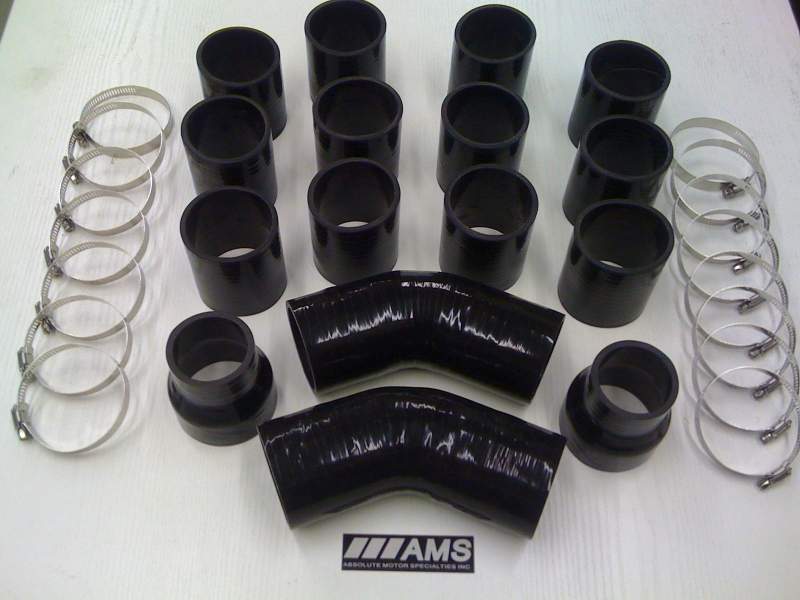

Here is the full kit...Ive used the silicon pipe to join to my FMIC.
In the other pic of the pipe kit you can see the brass take off on the other pipe ive not used.
Cheers
Those bottom two aren't intake hard pipes are they?
No mate ive used the ones for that.

The extra takeoff is for the IACV
I must admit i was shocked how easy the pipes fitted beside the rad as i was expecting a lot worse. They slotted in to place with no problem at all the newer version is much better.
So am i right in thinking the IACV pipe sits beside the passinger side of the engine and connects to the top of the turbo? (outlet) If so i have the wrong pipe fitted in place?
The other pipes im guessing are just extras for different setups? As from what i understand the airfilter pipework (feed) for the turbos are a separate kit?
