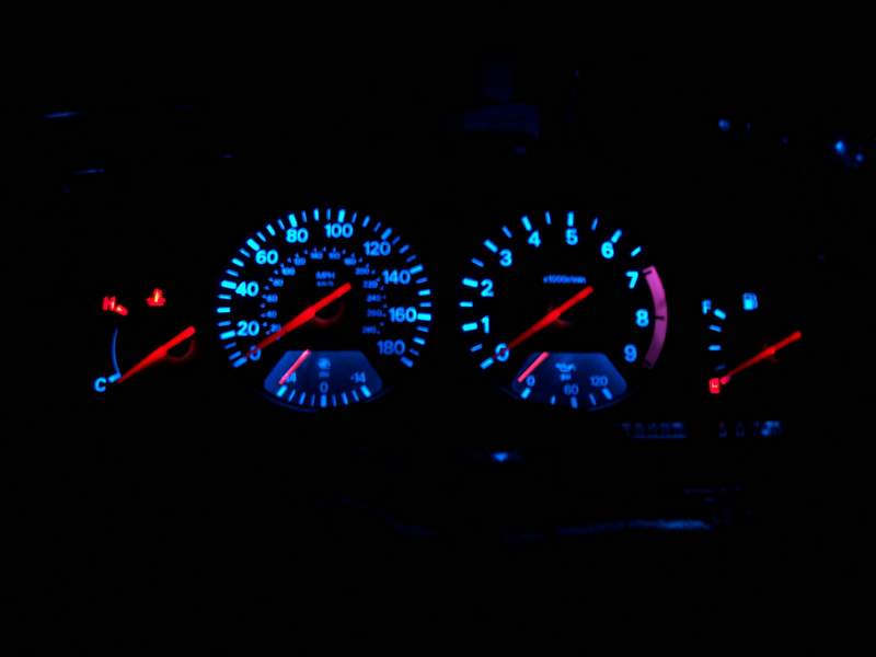

Get yourself a set of Uk clocks if you can, no need for a speedo convertor then and led them up
<a class=dash1.jpg' alt='dash1.jpg'>
Thats cool Mark, is it for a TT or NA? Mines a NA. That said my speedo and water temp gauge are spotless, its just the RPM and fuel gauges that are screwed. Would they be swappable?
John
they are for TT but the units them selfs are the same
RPM/Fuel/temp drop right in .. Speedo >> i would do is just check your speed against GPS/Satnav but you supposed to do this
when u have fitted EL lights or been playing with them anyways
£34 Posted m8 .. Paypal is ( Mark@drcorc.co.uk )
Mark
Mine is an N/A and i have UK clocks ( TT) the boost gauge obviously doesnt work for some reason :biggrin:
