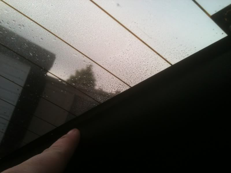

Is this the problem?

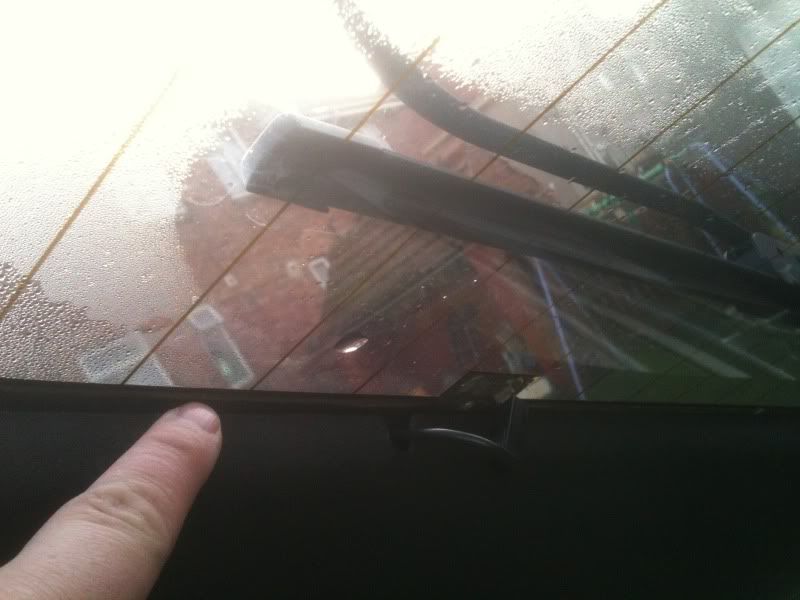

So this is the passenger side, looks like there a strip that runs from the connector to up and down the side of the window
The same thing on the passenger side looks a bit off
So then I take the trim back its not really attached to the window. Can I just glue it back and re solder the end?
Sorry for the poor quality photos

You probably wont be able to re solder the whole track, too much heat, be better off cutting the track that is hanging off and buy yourself r a repair kit, which is basically a metalised paint pen and redraw the track http://www.halfords.com/webapp/wcs/stores/servlet/product_storeId_10001_catalogId_10151_productId_203667_langId_-1_categoryId_255229
Thanks mate, I did glue it back up an solder it a bit yesterday but not working. So basically cut it off and draw a line lol

that was the bit that was causing my issues in the first pic . go carefully as groover said with the heat
test your getting a power supply at the plug end 1st
