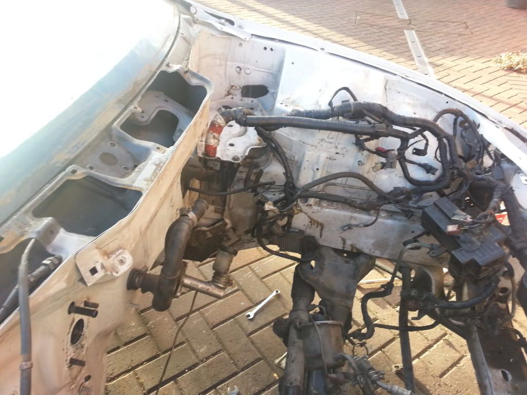

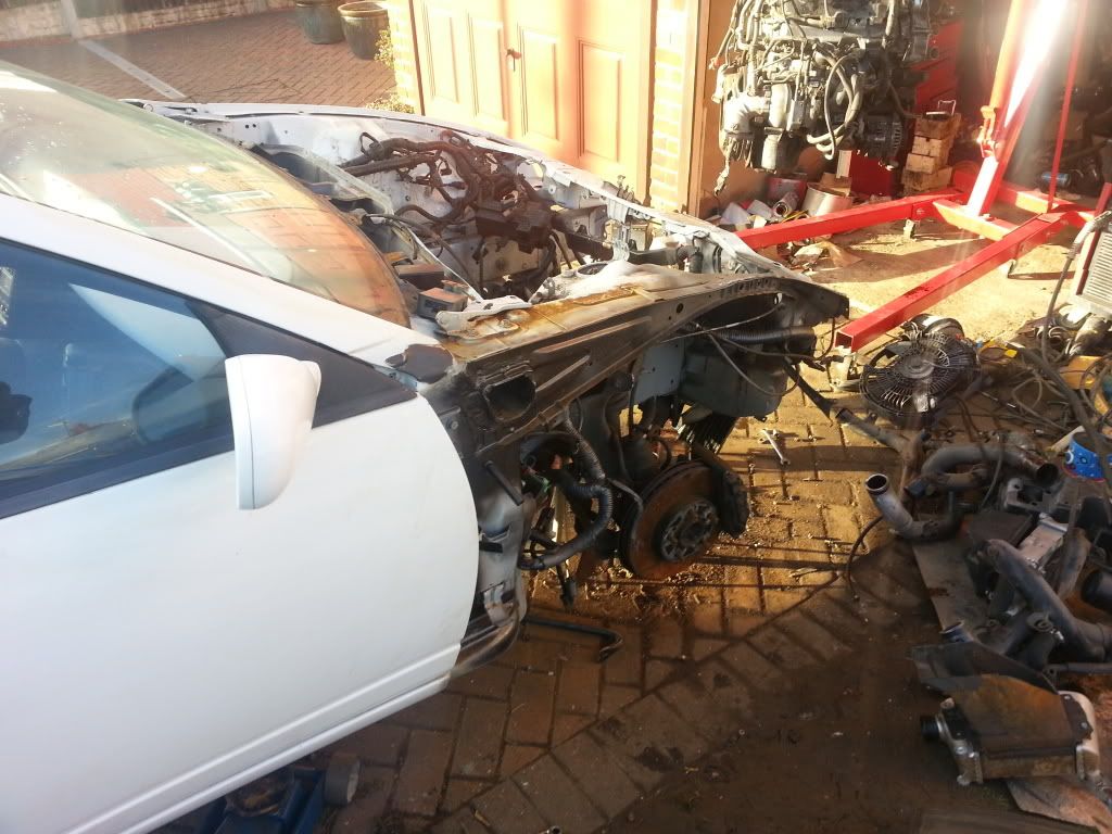

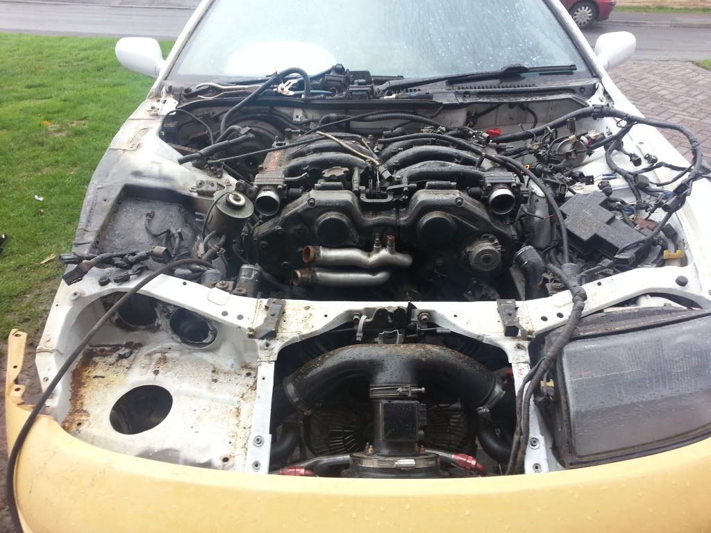

hi guys done some more to my stupid zed lol,
started at 12 yesterday had it all done by dark, and it was bloody cold....

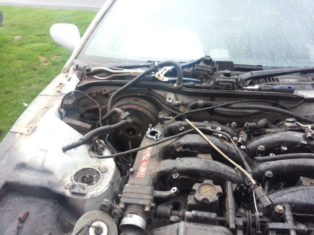

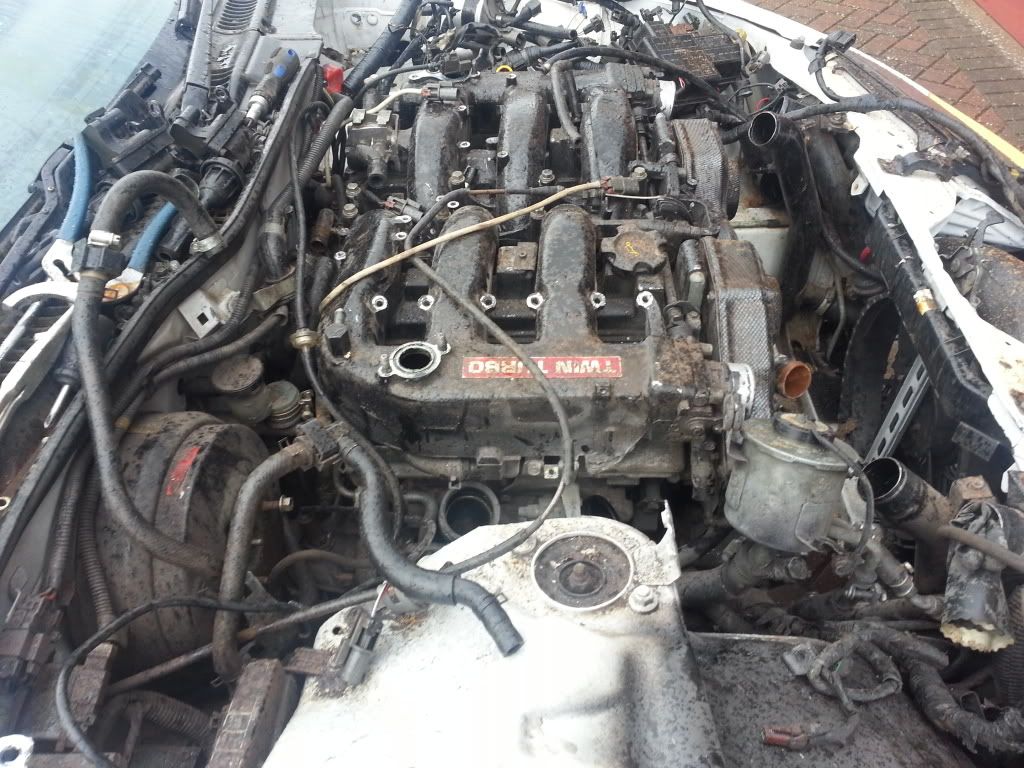

can't believe it looked like this couple years back..
and now this, what a mess..

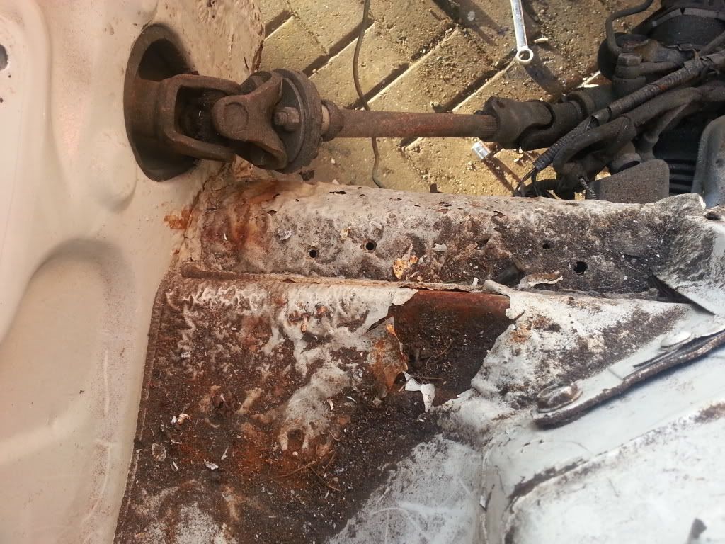

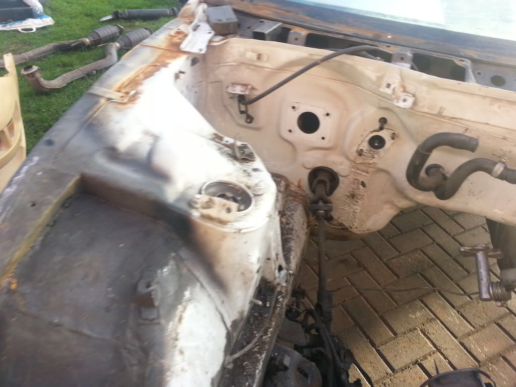

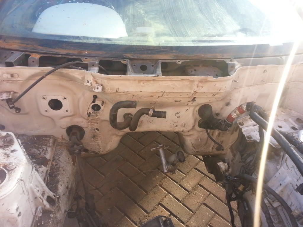

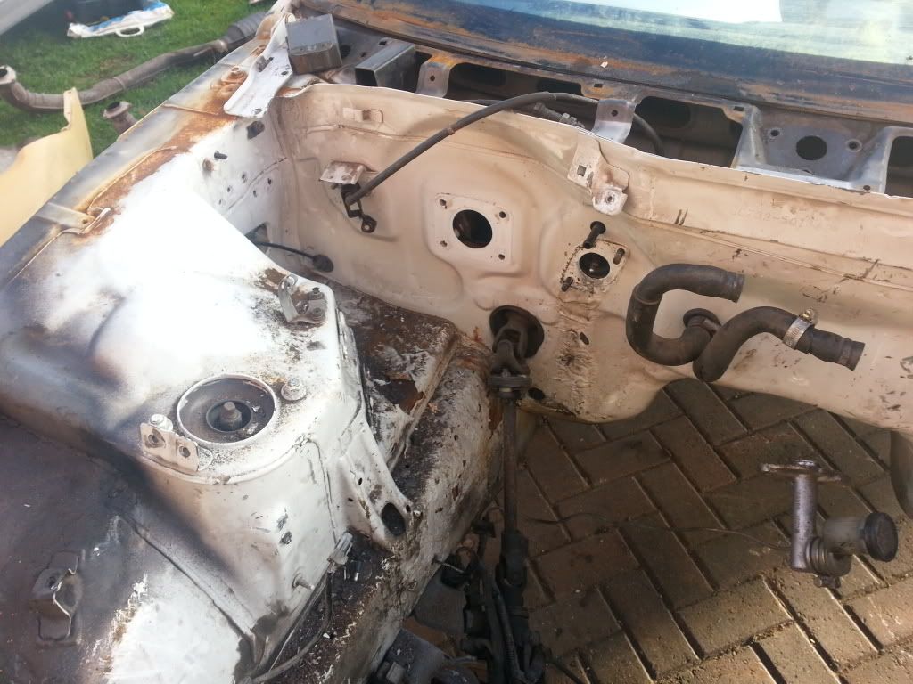

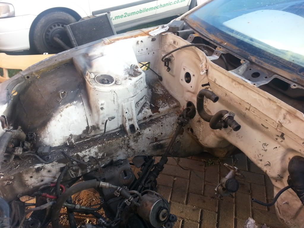

master cylinder on brakes leaked and took all the paint off, the clutch cylinder is leaking too. and my dodgy patch I welded in, is why one side of engine bay is black put some black paint on it to stop it rusting to I can finish grinding wields and make it flat..
goes in on the 15 for full paint post some after pics when it's all shiny and new looking.
thanks for looking.
sorry ain't been doing it 2yrs, had shell painted 2 yrs ago,
and that's the state of it after just 2yrs.
bloody master cylinders lol.
I made car look worse where I have been grinding all the little bit of metal have stuck all over the car and gone rusty too.
looks like spots of rust all over it.

Gotta be careful using a grinder around all that exposed glass a few metal flecks on that windscreen and it'll need a new one!!
window screen was covered in them. I did wipe it off and seems ok. I hope so cause its a new screen.
don't do bodywork and set on my car with grinder and welder, not good lol.
LOL best way to learn, just crack on and hope it goes well!!!! It depends what your cutting but what can happen is that the hot metal flecks can weld them selves to the glass then rust and when they do that there damn near impossible to get off, I'll never forget the look on the Site mangers face when we accidentally sprayed his band new glass lift shaft in metal 2 days after it had been fitted!!! needless to say my company got a 3k invoice a few weeks later... whoops lol
ouch , sounds bad.
I'm hoping it's ok now.
cause they were all over paint and window. I wiped them off the body with thinners on a cloth scrubbing hard and seemed to come off.
all the rust spots in the pics is from the grinding where I ain't wiped properly the whole car looked like that lol white zed with orange spots.
