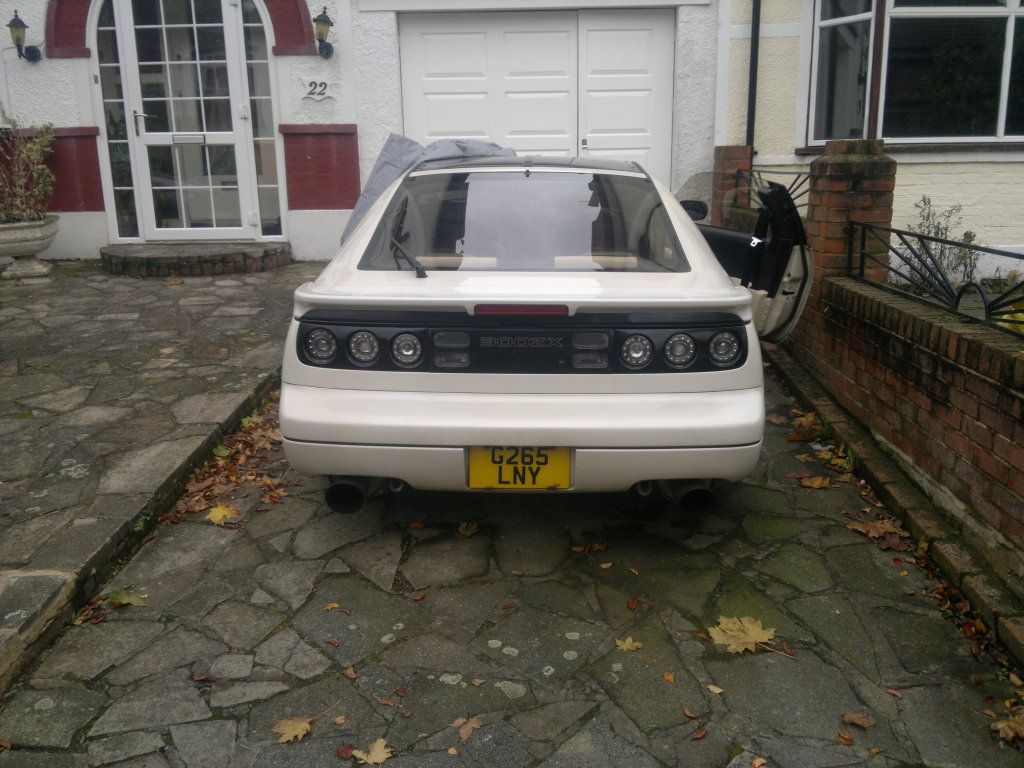

I have attempted option 3 just on the bench messing and found the filament bulbs were 'kissing' or very near to each other inside the chamber but with stumpier led bulbs for both the reverse and fog this will not be a problem and will also help keep the heat down :clap: this is actually a good balanced way of dealing with the jdm fog light issue.

As for 6 pit lights................ just no!
