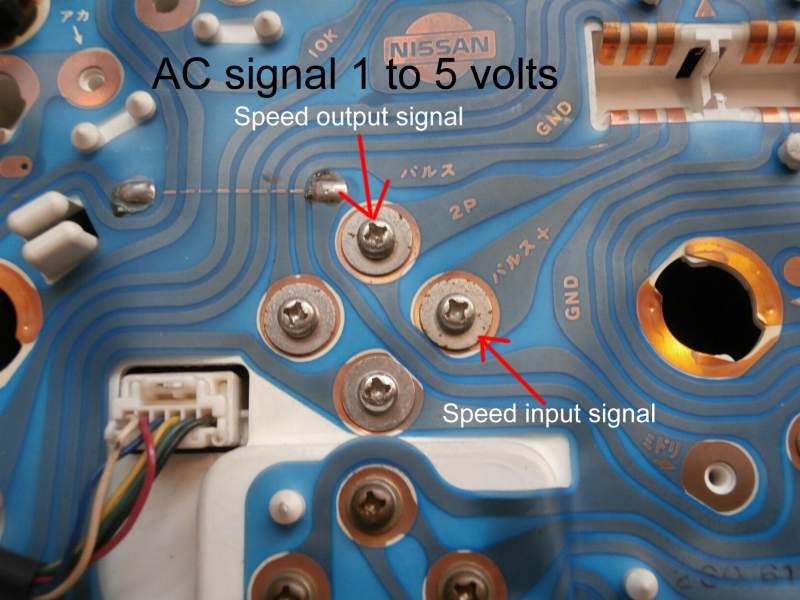

Here is the layout you need to test your speed signal, could pm you as your not subscribed.
Jeff TT
cheers jeff will give it a go once i get my volt meter back off my mate hopefully its not the cabling that needs replacing.
