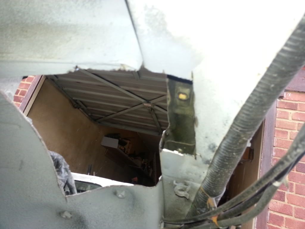

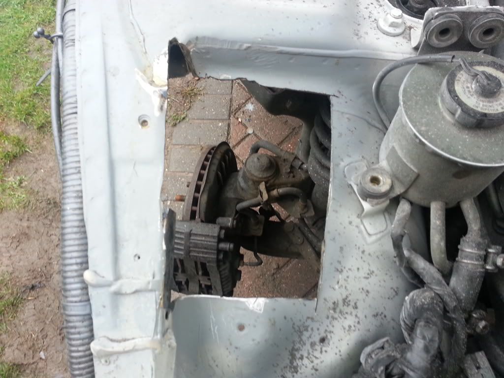

big hole
oh dear,
I made a big hole lol,
found some rust in the seams so decided to cut it out and at the same time I will be able to get rid of where my hicas use to bolt too.

To bloody big lol,
it had to come out there was rust in the seam sealer,

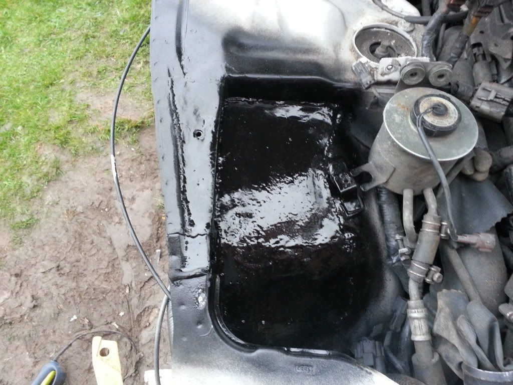

This is what' I have done, hopefully it will be ok,

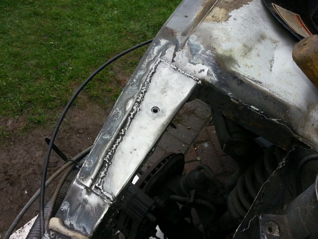

started grinding welds down but rain came again lol, so just sprayed some primer and black paint over it to stop it rusting till next weekend, then gonna grind wields flush and put thin skim of filler over it.

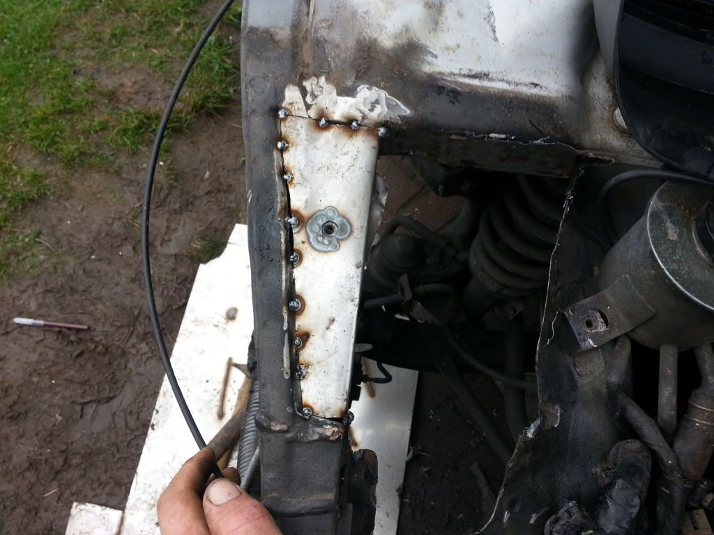

bolted two pieces of angle iron together to make a brake to fold metal to make the little bit of box section, and drilled an hole welded a nut on the back where the wing bolts too.
then welded the box section

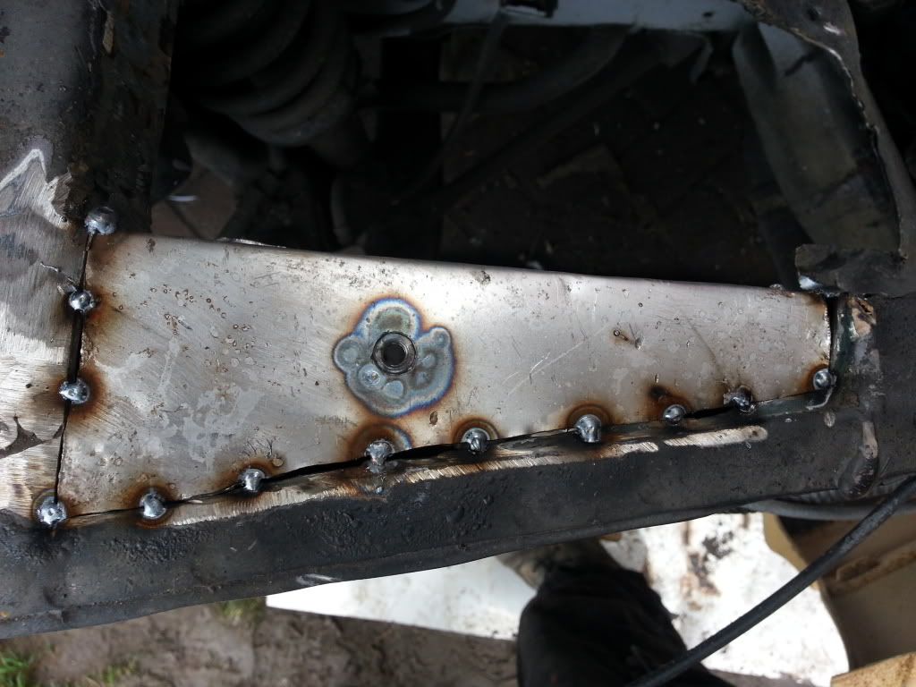

then had to make the big flat part In a couple pieces, this is where it got hard and made it so it didn't have 2 pieces of metal against each other like factory with seam sealer.
I just welded it to the sides,
and then it rained so painted it black, so don't rust, it looks terrible I know but hopefully when I grind wields down and skim of filler I hope it shouldn't be seen or I'll start again.

Anyone reckon it will smooth out or have I done it so wrong lol.
do u guys who weld bits and smooth them use filler or do u get it right that u don't need it.
your doing OK m8 just as long as you weld it all in 1 strip as the metal will warp, as you have the little welds is ok then join the dots from both sides middle out to the next set of welds, that way the heat is distributed, then grind it back and use your paintable seam seal in but the attempt is good.

the seam sealer will give it that factory finish once you paint over it, do it right and it wont trap the water, you can get brushable sealer. if you fill it, it will be alot of work in the corners etc when you try to smooth down before prep and paint. its up to you m8.
