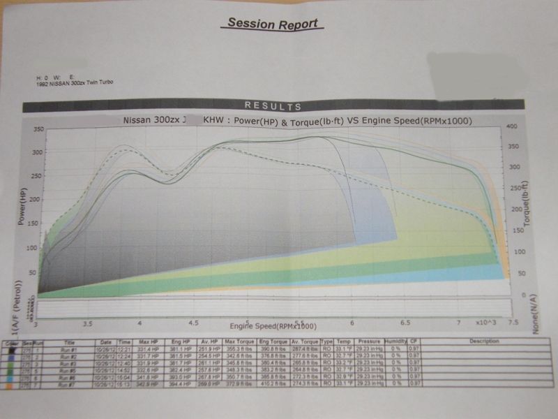

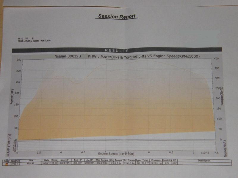

Finally got chance to do a bit of tweaking on the dyno:
394.4 bhp & 410.2 lbft (fly)
342.9 whp & 372.9 lbft (wheels)
Stock engine, Auto turbos, stock intercoolers, stock exhaust system inc. cats with aftermarket backboxes, stock 370cc injectors at stock fuel pressure. Just air filters, one of my boost controllers, back boxes and mapping voodoo :ninja:
Still got more to go. Not bad for a chip, eh?

well come on then put of the dyno plot ..
where was it done at ?
Haha, impatient!
Dynocom dyno.

whats with the 4200rpm drop in power ?
and why is it only showing the graph from 3k
Kickdown to 3rd (1:1). When an automatic is on a dyno and there is no way of locking the box into a specified gear, you start it at 3k RPM as it helps to force kickdown to 3rd.
Didn't have time to disconnect the kickdown switch, and have not looked into if this is feasible (but can't think why it wouldn't be).
Results in line with a 110mph 1/4 terminal with a lardy 300zx.
that would explain the dip to .... didnt know it was Auto m8 ...
50hp is quit a big transmission loss but suppose thats cuz its auto
