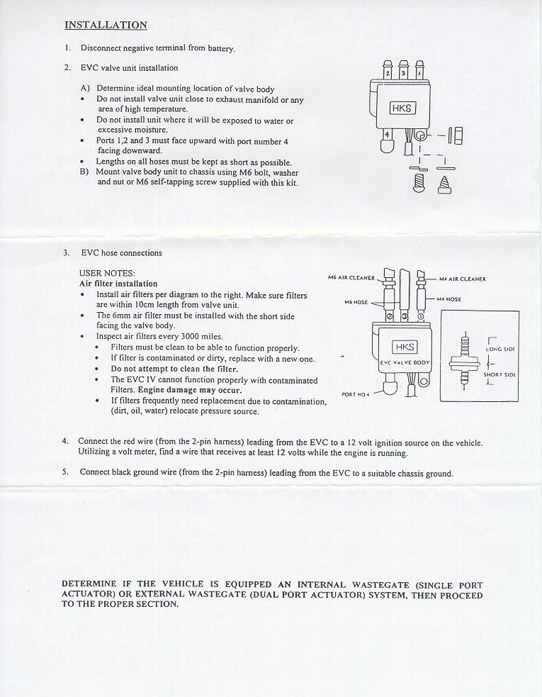

You seem to be missing the two in-line air filters for the valve body. They should be fitted within 10cms of the valve.
You can see them in the picture I put in the Garage section along with the valve placement chosen to keep the hoses
as short and equal as possible.
-Andrew
yea, i did see them, but i've heard of the elements in the filters themselves breaking down and stuffing up the solenoid/valve that way so went without
Never heard of that happening. I would be more concerned about debris entering the unit and damaging the stepper motor functionality. It is
a precise and efficient design and is very good at holding a steady boost and catching boost spikes as they occur.
-Andrew
catch 10! :P :P i do have 1 filter knocking around.. any preferred port to put a filter on?
This is the part of the installation quide I have for an EVC 4 which covers the valve body install (including filters). The valve bodies
are similar if not the same for both marks. The filters are HKS 4599-RA017 4mm filter and HKS 4599-RA016 6mm filter.
-Andrew
