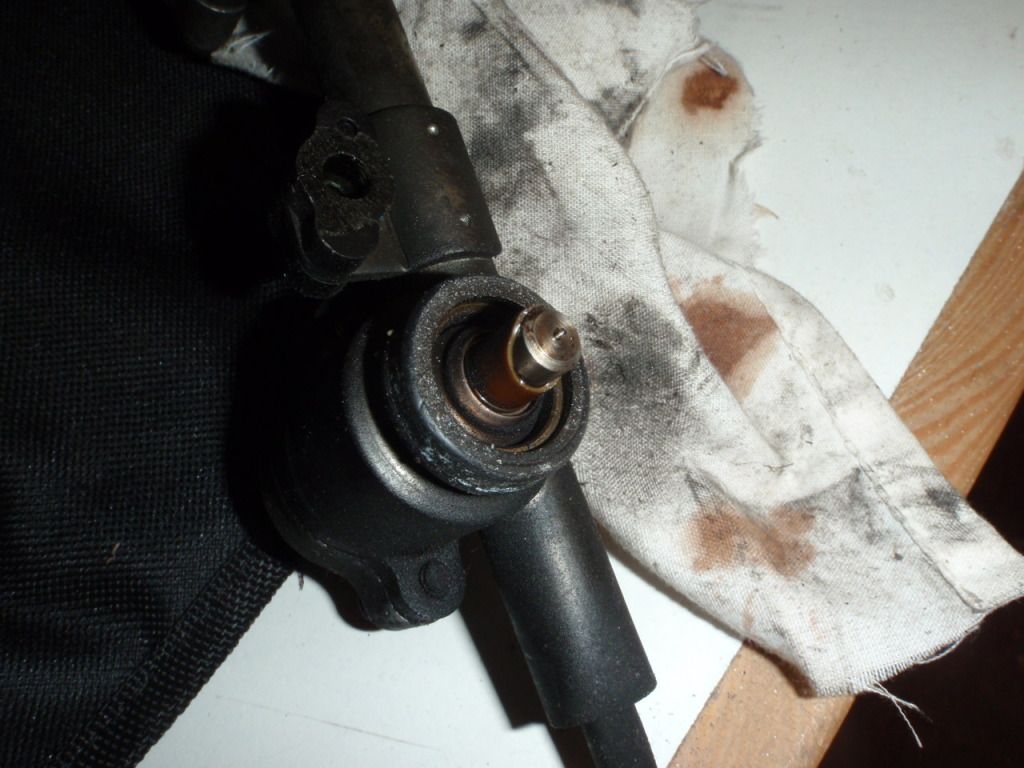

Yesterday I removed my fuel rail and have found two of the injectors have lost some of the cover off the end. Is this a problem, should they be changed?

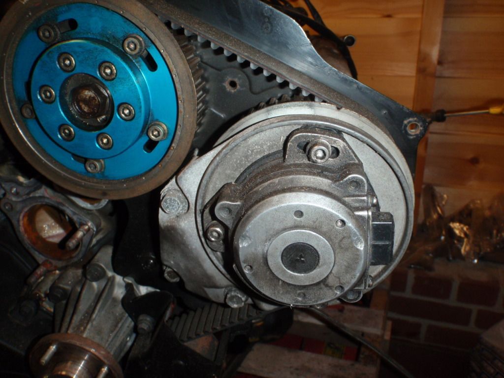

Can anyone identify what series my CAS is?
Cheers Mark, I was searching for pintle caps and had no joy but just found them on Z1 as 'injector caps'
