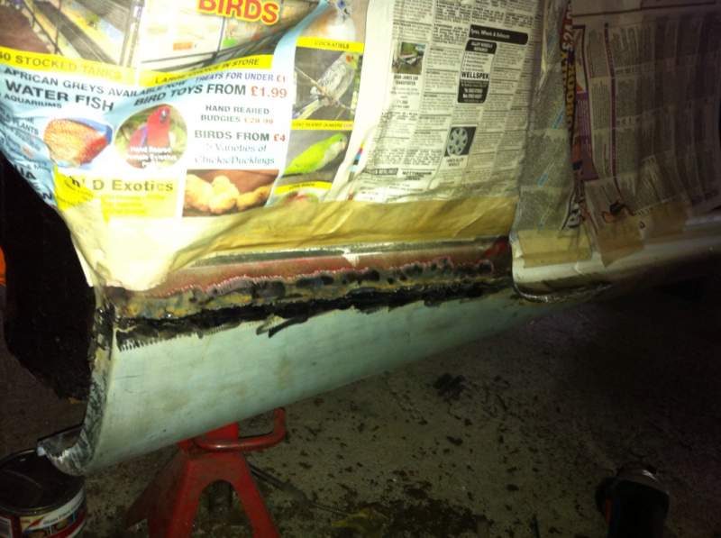

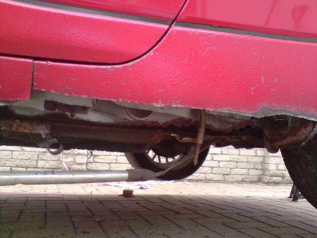

Pics attached (having cut away some of the rot to see just how much solid metal remains)

I heard about the targas draining through pipes into the sills, but having cut away some rot I can see the rubber pipes fit into short metal pipes that then drain through a hole in the bottom of the sill and out of the car. AFAIK this is original, not after market. You can see one of the short metal pipes clearly in the second photo

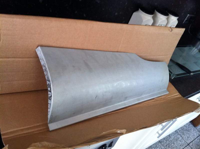

I ordered two sill return repair panels from MJP £75 plus VAT each. Anything else that needs patching up gets fabricated. Actually the nearside sill itself is pretty sound and the offside sill needs about 3 inches plating over. It's just the part beween the sills and back wheel arches that are really bad
