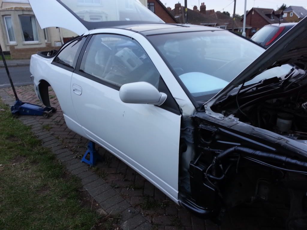

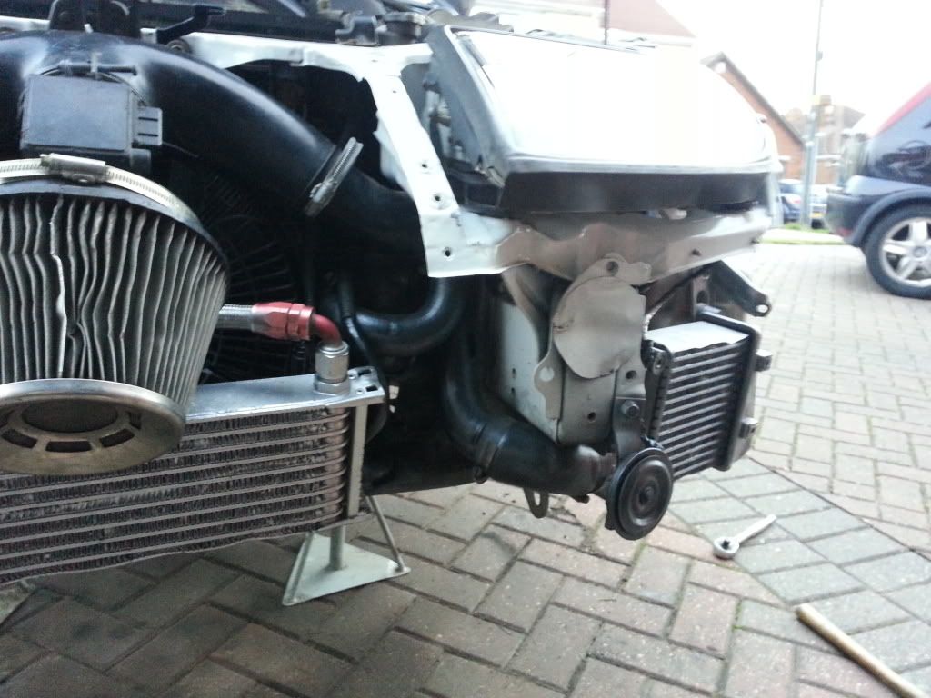

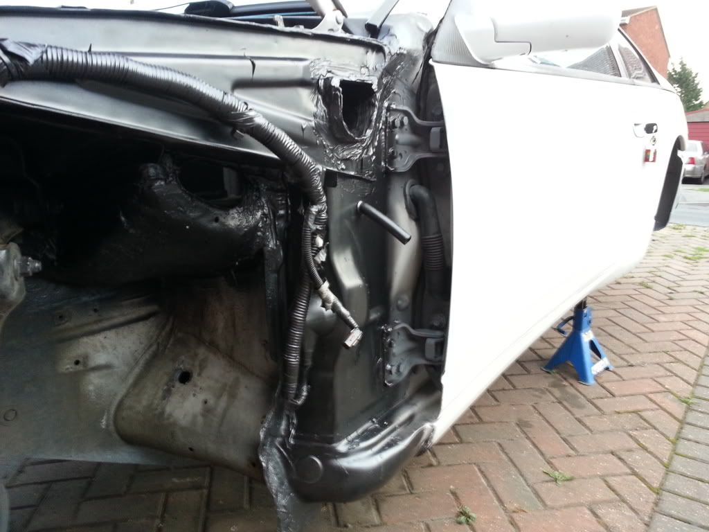

Some more done to my poor zed.

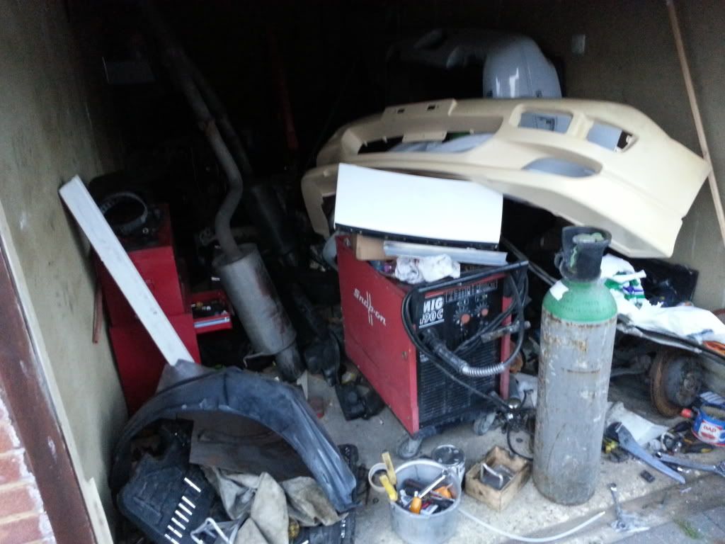

Some pics of my poor zed looking in a right sorry state and my bloody garage cant even get in there.

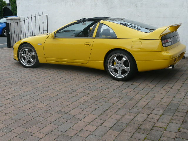

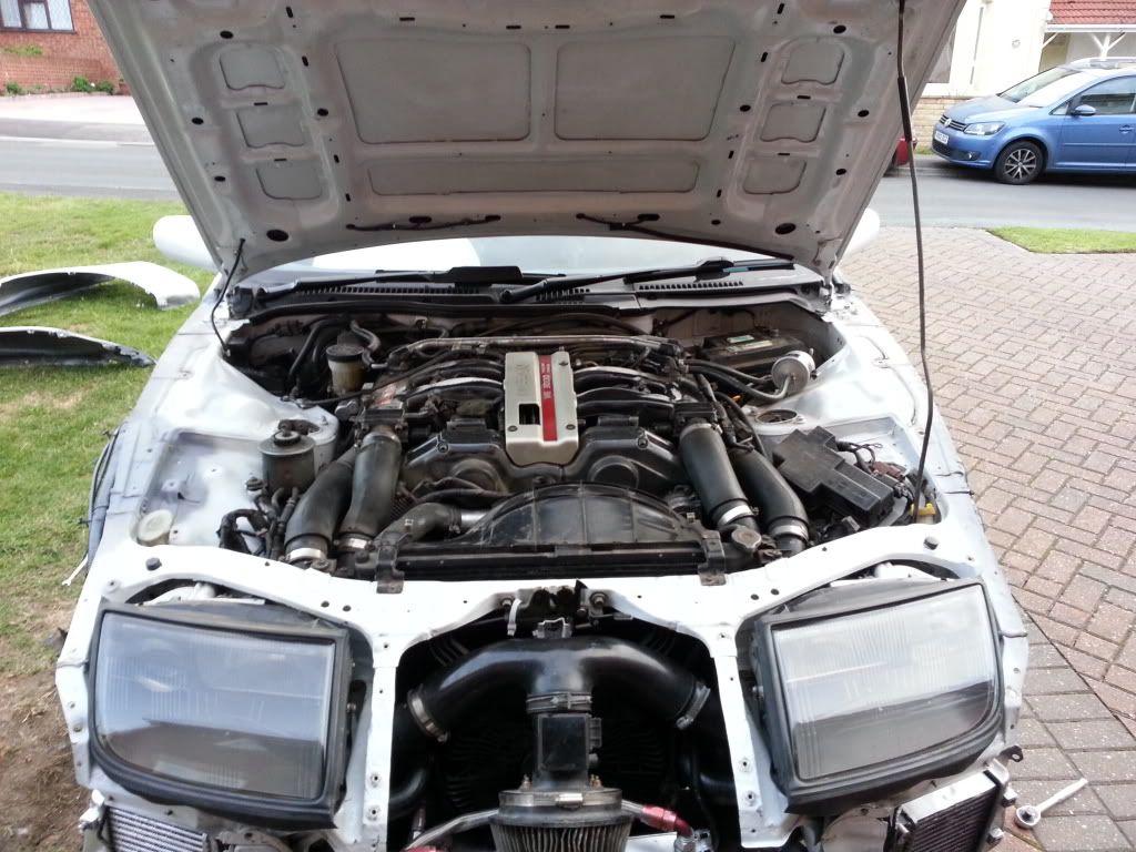

And some of how i want it to look.
My poor garage:

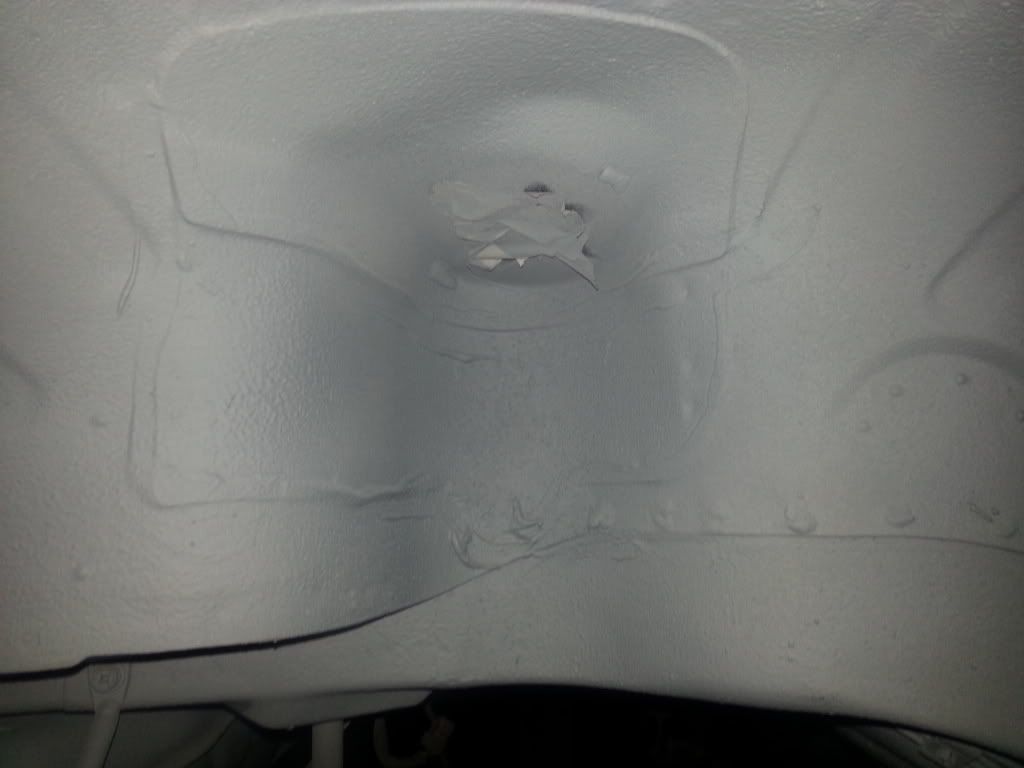

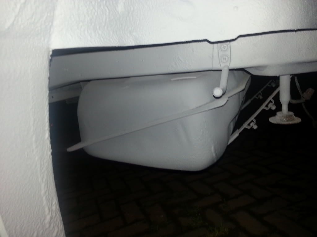

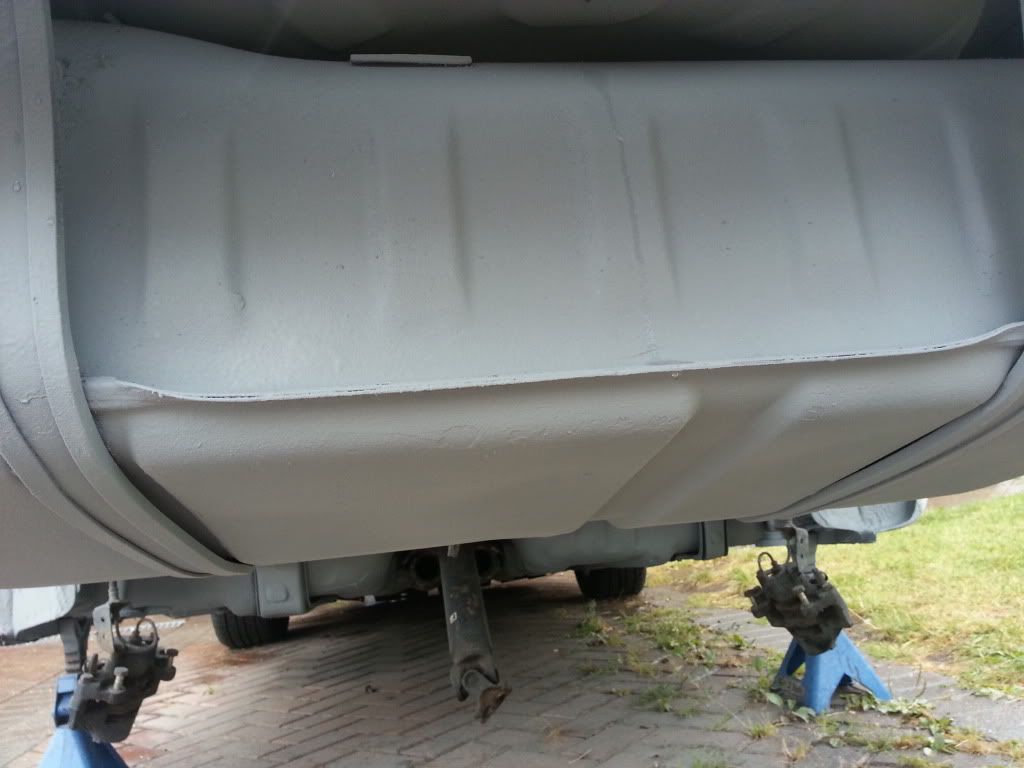

Gotta dinitrol in these like the rear arches and rest of underneath:
Like this the rear:
  • Replies 29
  • Views 897
dinitrol grey stone chip,
bought it from ebay the subaru kit, comes with cavity wax, stonechip, a clear wax heat proof for engine bay and rust remedy/primer stuff.
was just under £100 for the lot with a schutz gun to spray it which also has a long extension so can poke it in the seals and box sections and sprays out in all angles.
the underneath stonechip stuff can be painted over too its a type of rubber paint, gonna paint it black i think lol.
