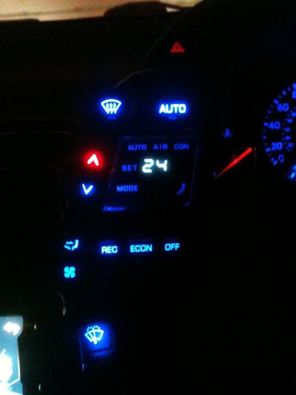

If you are using a series 2 air con pod, ie pic of the seat in the window, with a series 1 ecu you will not get the ambient temp figures in the window, just some dashes.

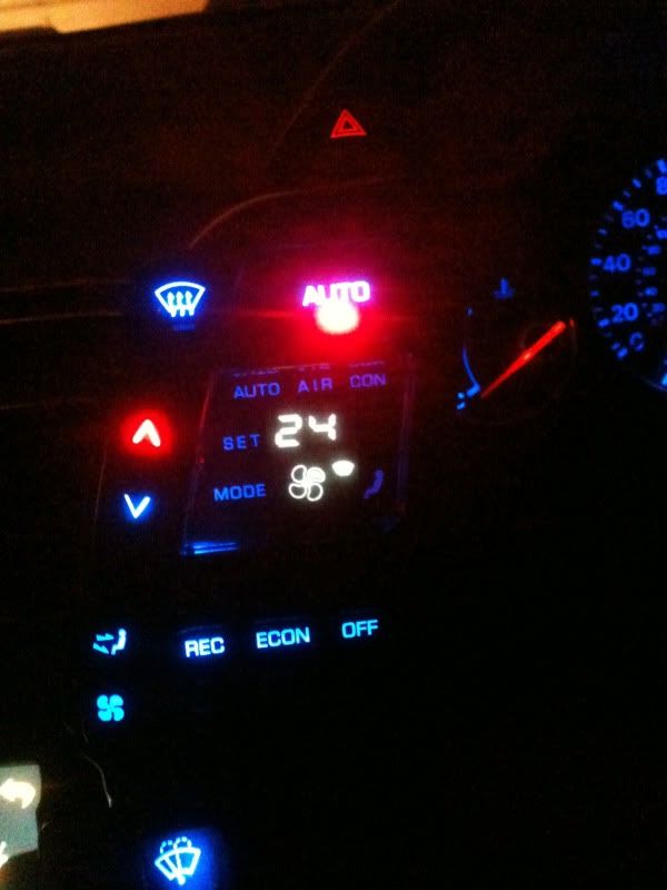

Series 2 pod and ecu, you will get a pic of a fan in the window and direction, when pressing the buttons along with the temp figure, but no second digit ambient temp figure.
