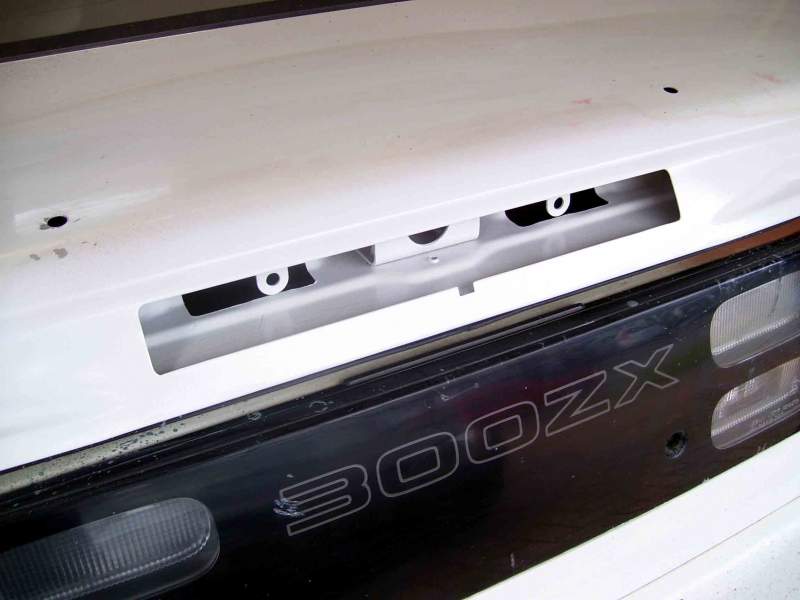

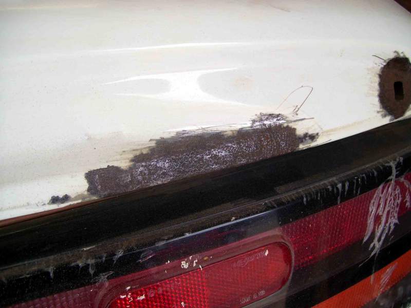

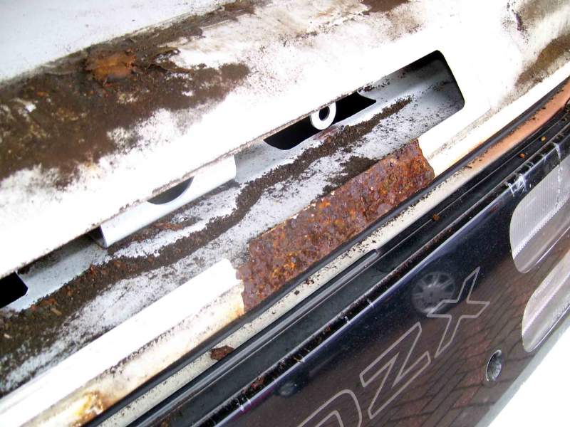

Finally decided to remove my rear spoiler today, not as bad a job as first thought.
Corrosion was not that bad either. Bit of repair work to do with the old mig welder but all in all, not that bad.

Well, at the risk of being boring,
I made some good progress today with regards to the second area of tin worm.
The easy bit was cutting the stuff out, but fabricating the repair piece was a different matter.
Still, got there in the end. And even if I say so myself, turned out pretty good.
Almost invisible.
