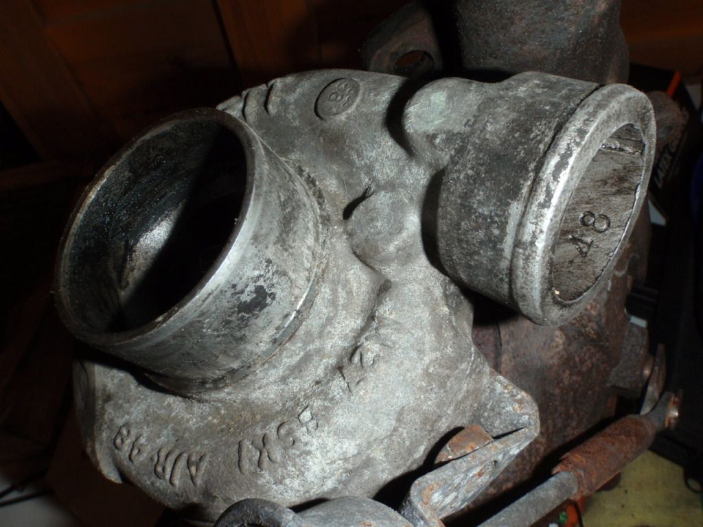

Thanks guys, I need some further help. I just went outside and took a pic of the ID plate but I can't find any specs from the numbers. Which one am I supposed to use and are they O's or 0's (zeros)?
