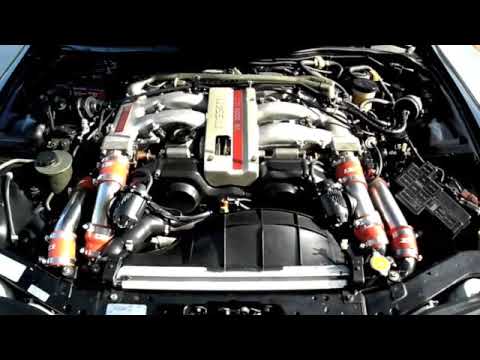

my current set up is as below
However I want to put some samco chrome hardpipes on.
Can these types of BOVS be relocated? if so where and how difficult a job is it?

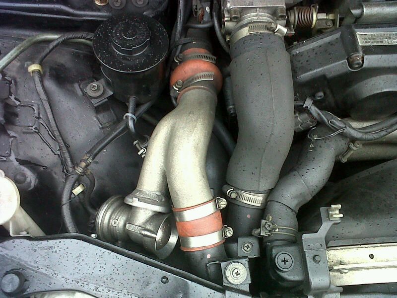

yeah, my previous ones where down neat the intercoolers on the old recirc pipes... you will however need an adaptor..
like this (but obviously you have to get the right size)
http://www.ebay.co.uk/itm/Universal-Adapter-Flange-O-Ring-Circlip-For-Fitting-HKS-SSQV-BOV-Blow-Off-Valve-/400313239911?pt=UK_CarsParts_Vehicles_CarParts_SM&hash=item5d34874967
the other option is to put them on the pipes to the TB's but again you need the hard pipes...
like this..

harby - that conceptsz kit looks like it is still only meant for the original location in front of the aircon rad.
i believe you will need hardpipes with built on flanges, as pictured by medallion man.
Youre right John. decided to leave the hard pipes until I can afford to change the BOV's for an upto date set or see some one selling a set on the forum...
