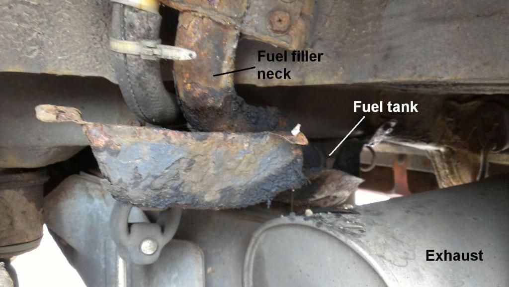

Might also be worth checking the tank whilst you are there, the straps go first, then it eats through the tank where the straps sit!

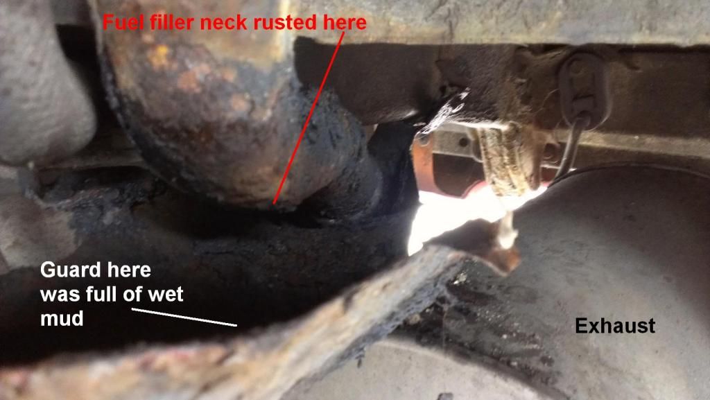

Ok guys I've managed to get the wheel off (damn silly aftermarket alloys witn non-standard size bolts grrr) and can confirm that it's definitely the fuel filler neck that's the problem. After removing the first guard I could see the guard underneath the neck/pipe was absolutely full of wet mud, coating the neck - probably helped rot it! Scraped all the mud out and I can see that the pipe is in a very bad way and that's where my leak is.
I've done some photos with labels so anyone else with this problem can easily see.
Wheel and first guard off:
Can see the fuel filler neck location here:
And where the mud was:

looks familiar lol. Had this on my uk too, same mud trap. Worth checking the area above the neck in the arch as this traps it too, had to treat that area and i replaced my filler neck with 2nd hand one, painted with hammerite..all good 5yrs down the line. As stated pretty easy swap.
Ditto, give the panel around the filler cap a good check mine was fubard as well, and seen it on others. I had to make a new section up.
Just make sure you give the replacement filler neck a good clean and plenty coats of protective paint.
