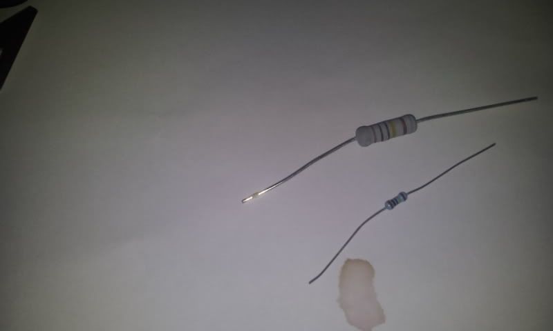

Went into the shop but they had 2 the chosse from a 0.6w and a 2w. Which is the right on to put in? Leaning towards to 2w as it is larger but wanted to check to be on the safe side
try find the watt value of the dett sensor which its going to replace...i think it would be 0.6w

Either one will do, So long as you have got 1 meg ohm resistance you will be fine.
I think the .6w and 2w respectively is showing the level of wattage they can handle.
cool had a look in old threads and both seem to be used and as they were only 30p each was easier to buy both and find out later

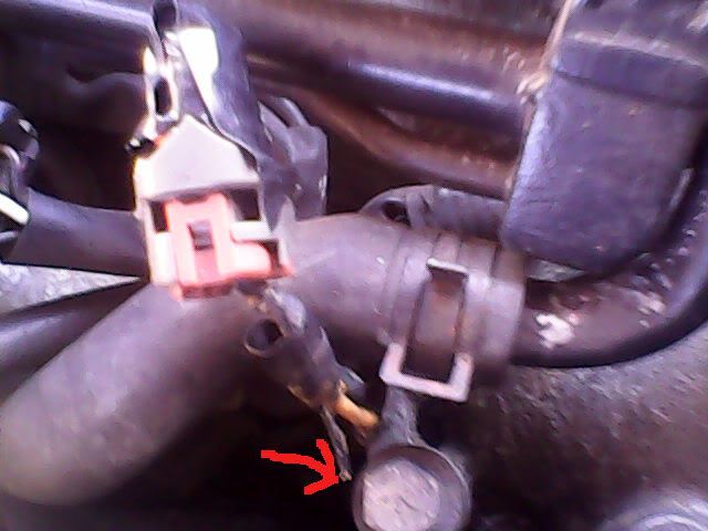

Been out to fit the resistor and it looks like the black cable coming out of the plug has been cut!
Is this what is likely to be causing my code 34 rather than the sensor itself?
Edited by Cyberbean
nope thats Normal ...
only the white wire is connected it takes its Earth from the engine its self ( bolt ) ..
just do your resister bypass on the main Loom side on both black/white wire
Have done that, just to check the resistor goes onto the male side of the plug?
That's the side I put it on but is also the side with the cut wire so by the look of it i'm making a full circuit to nothing.

The main loom side connector is the female one.......hope it solves your problem bud!
agree and just solder the resistor on to 2 spade conections and fit into the female plug...the "live" side of any loom is normaly a female socket so its protected from touching earth..htp.

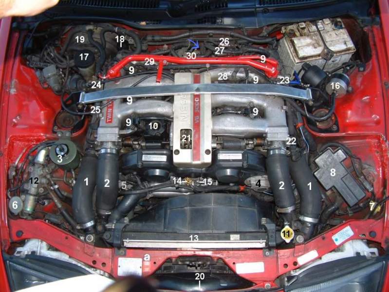

Getting a bit confused I connected the resistor to the connecter that I have put the blue arrow on, but in the engine by numbers FAQ the det sensor is labeled as number 26.
Which one is correct?
That's the FAQ that I was following but got confused when getting conflicting information.
My DET sensor sits where the pexcom write up points to not the engine by numbers diagram. However it is possible to jumble thos rear connectors as I have previously plugged it into a VTC one on the loom mistakinly! Best way is to look at the wire colours on the main loom side connector

DET sensor should be a white and a black wire(earth shield). The VTC connectors should be a red/black and a green/black wire.
