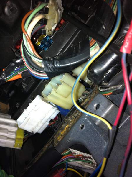

Right I'm nearly there with the fuse box - I ran the Z again and I'm 95% certain the buzzing is coming from behind the fuse box so after nearly breaking most bones in my neck and spine I've got it to the stage where everything's unplugged but I need to unclip the sockets from the edges of the fuse box - especially the three in the centre of the first pic - how the hell do these unlip? Do they come forwards or go backwards? I've got no strength or skin left in my fingers to try them any more!

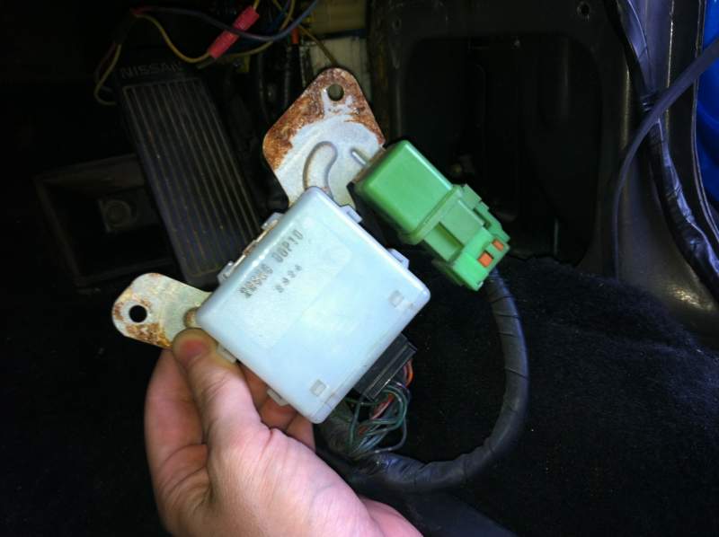

Also, what the heck is the white box in the second picture - it's screwed to the body next to the fuse box?
the best way to get the fuse box out (because there are relays on the back of it) is to undo the accelerator pedal and the bonnet release.
if you can see the part number you could look it up here..
http://www.courtesyparts.com/300zx-parts-z32-1990-1996/genuine-nissan-parts/body-electrical/253-electrical-unit/-c-882_883_923_929.html
looks to me like the the timer control... (other side in the USA)
this one make it more clear for our cars... (UK)
http://nissan4u.com/parts/300zx/er_z32/1992_3/type_1/body_electrical/electrical_unit/illustration_1/

Tcu ( Time control unit) controls intermittent wipers, dash light dimming and interior light delay if working
Thanks Groover. The above are working, at first glance it looked like the white box should have some sort of fluid in!
