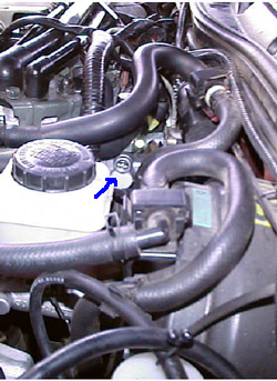

if so, then easy to adjust the idle... back of the engine (near the batter)..
http://z32.wikispaces.com/Idle+Control
Fully warm up the car.
Turn off engine.
Disconnect the electrical connector for the AAC valve (yellow) points upwards.
Start car.
Turn the Base Idle Screw clockwise until the idle drops to about 650 RPM.
Reconnect the AAC valve's connector.
The idle should quickly raise, then gradually settle down to about 750 RPM.
Thanks for reply mate,had a look can see the adjuster screw but no yellow connector block?i turned it clockwise and it did slow down a bit to 1000rpm then ran out of adjustment but no doubt it will rise again as i couldn't find the yellow connector block to disconnect lol.
does this help...
it's the connector with the yellow dot (the higher one when on the car).... the "T" piece is at the top (when on the car) and the unit points away from the battery, so you have to lift cables to see the connectors.
let me stress that turning the screw with the connector still on won't help at all!!!!
but have you done all the other checks as well? if not you could just be making things worse.
you can just see (in the pic) the connector behind the screw...
