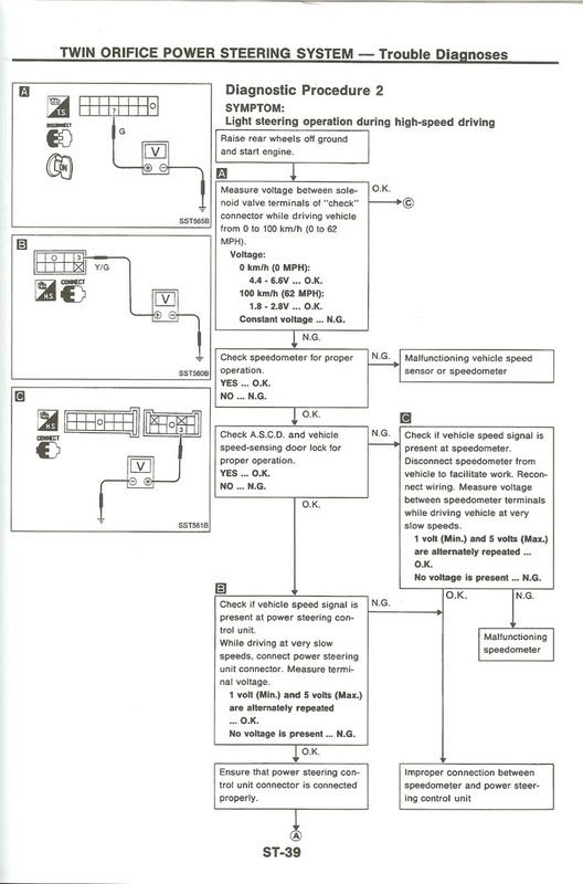

think i might need one
why do you think so ? if your speedo doesn`t work and you don`t have power steering is usualy clocks...
speedo stops working at times and power steering becomes heavy

I had the same problem so changed the clocks but it didn't solve the problem. The miles have stopped clocking up as well so think it has to be the speed sensor
