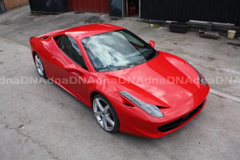

decided to approach the fakerrari by starting at the back and working forward!

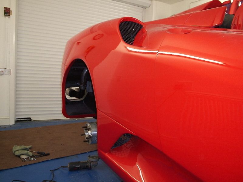

Cheers chaps!-done a bit more........
With the diffuser fitted the ar5e end wobbled,so made a couple brackets to support it,now solid!
Trying to show upper and lower grilles fitted with this pic and failing! LOL!

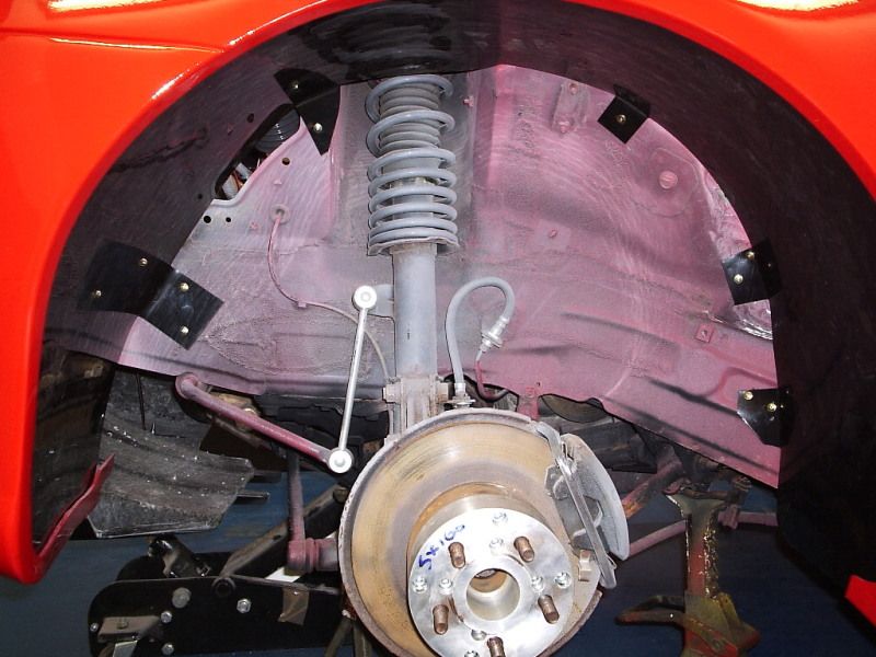

Inner air duct was then bonded in and the arch liners fitted,these are a git!-loads of trimming,trying etc.........
Got to squirt some underseal around and other than the brakes the rears done.

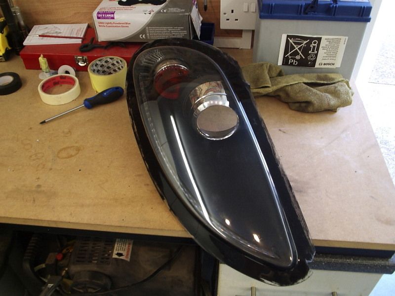

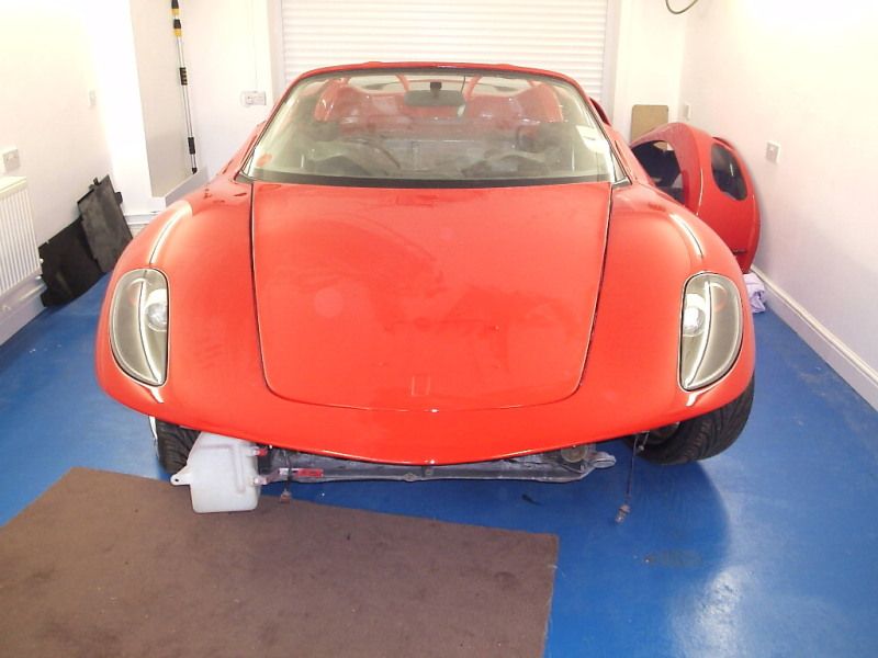

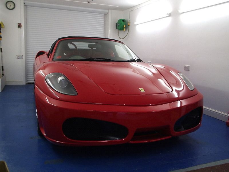

Had a go at the Headlights Today,they both need building up from bits to this.......
Then they go in and aligned as near as possible before bonding to the mounting!
Got both done and bloody glad that's over with!
:ninja:

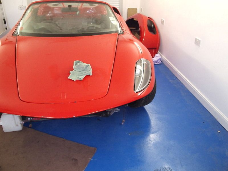

Knocked up a beam setter to get the headlights somewhere near..
photo upload
Found the rad is Fubar!-still glad I found it now while it's accessible!

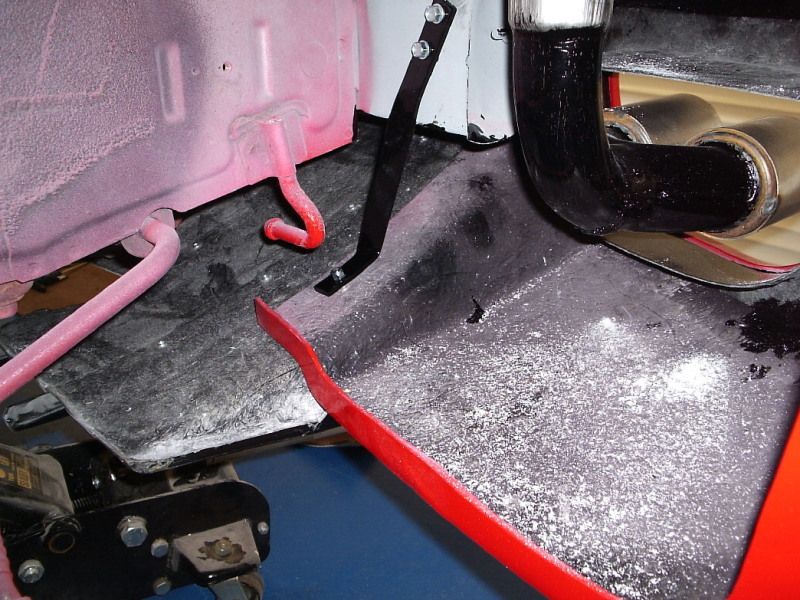

Whilst the front is stripped thought I give her a coat of underseal....
photo hosting
And got carried away and did the lot!

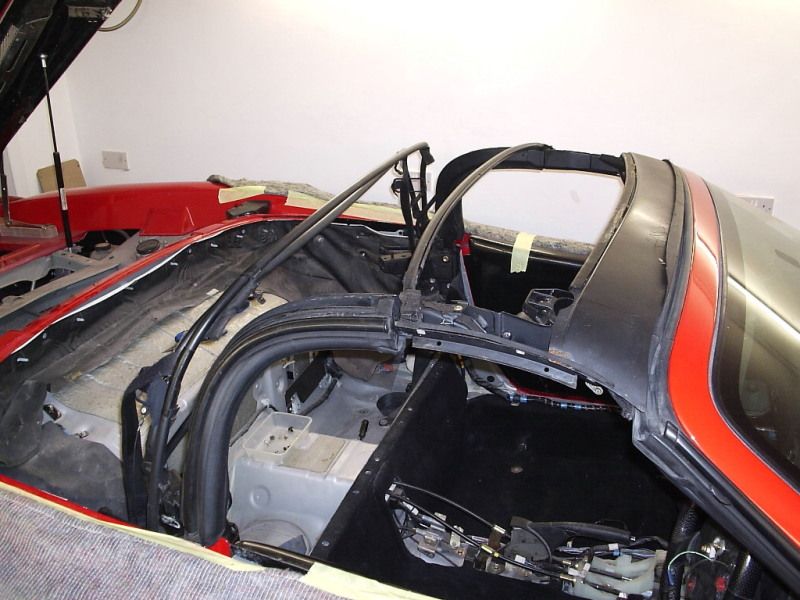

So I thought I would add hood fitter to my C.V LOL!-hey,if I bugger it up I'll take it in to be done!
First thing was to fit the hood I won on E-Bay as the car came with just the frame and bits missing!

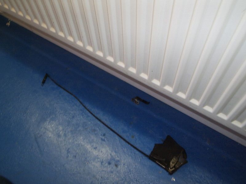

Two cables like these for a start,

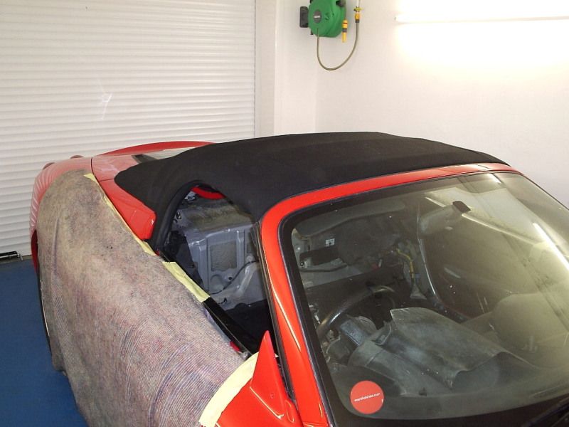

So got the hood fitted and went about cutting the original off.....

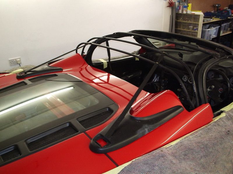

Next job was to fit the rear 'turrets'-these shape the rear hood,

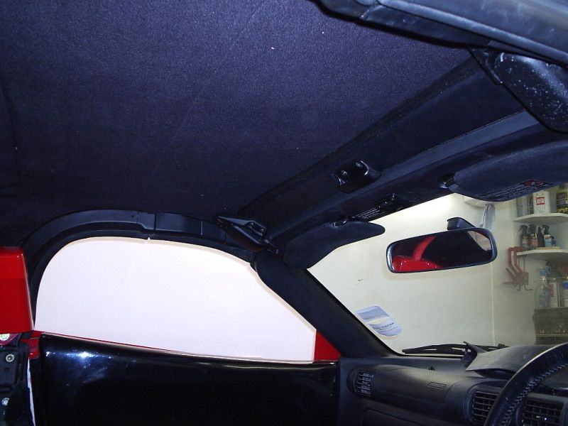

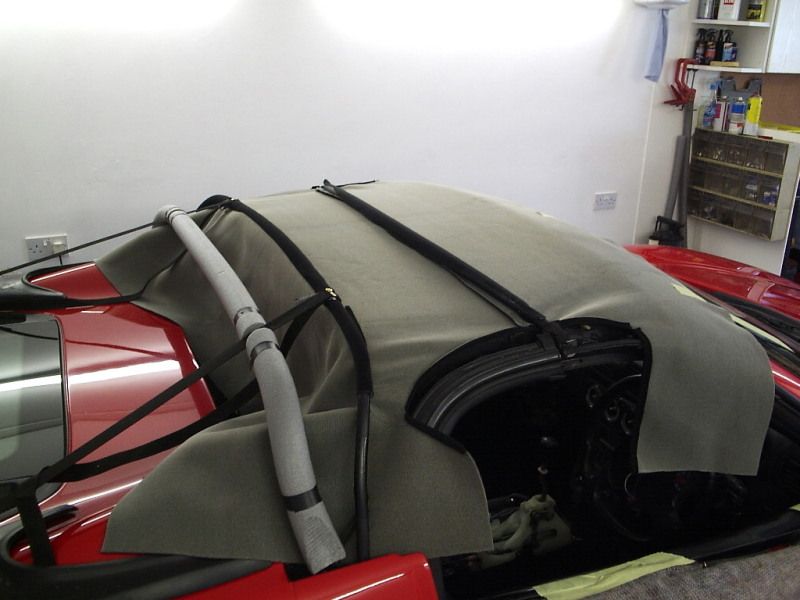

The headlining goes in first,the bugger is to keep it all tight as you go,

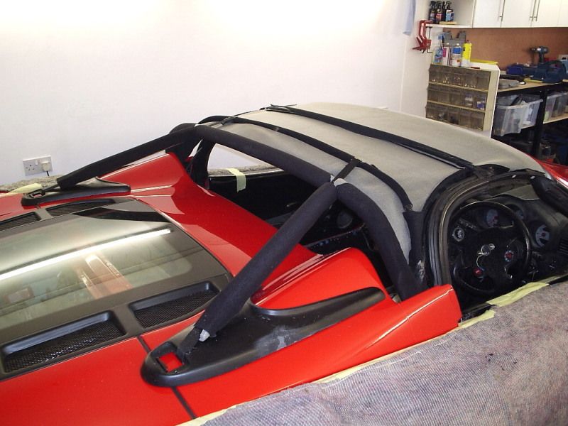

Headlining done and straps etc padded.......

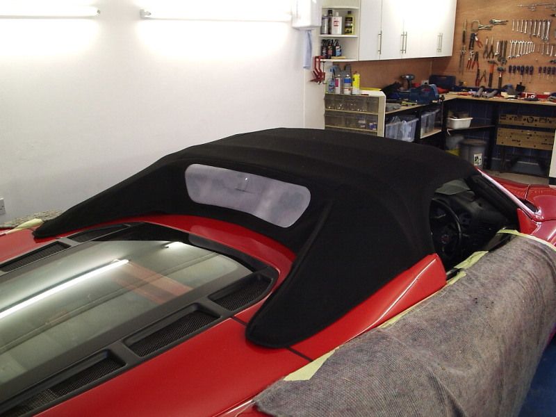

First trial of the hood,not looking too shabby!
Still have to fit an inner carrier under the window,this is pulled tight inside the car......
Hopefully Tomorrow should see it done:whistling:

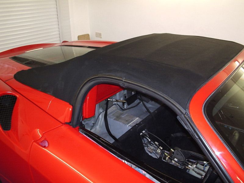

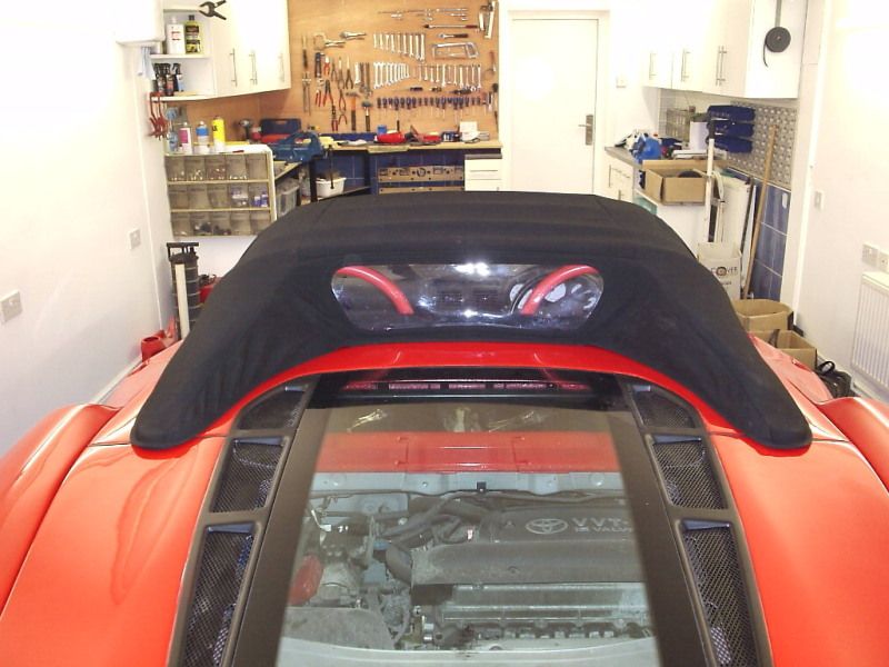

Finished at last!-not a nice job but one of those 'now I've done one......' cases!
Quite chuffed with myself actually,rag tops can look proper shite if not tight etc.....
Rubbers etc back on,hopefully water proof!
Even the headlining turned out nice (yes i'm surprised!)

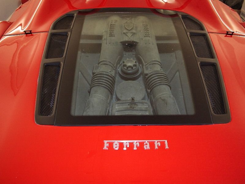

although it's a shame you can see the toyota branded engine through the rear hatch cover.
looking amazing mate :thumbup: wish i had the money and skill to do something like this.
For now!:whistling:

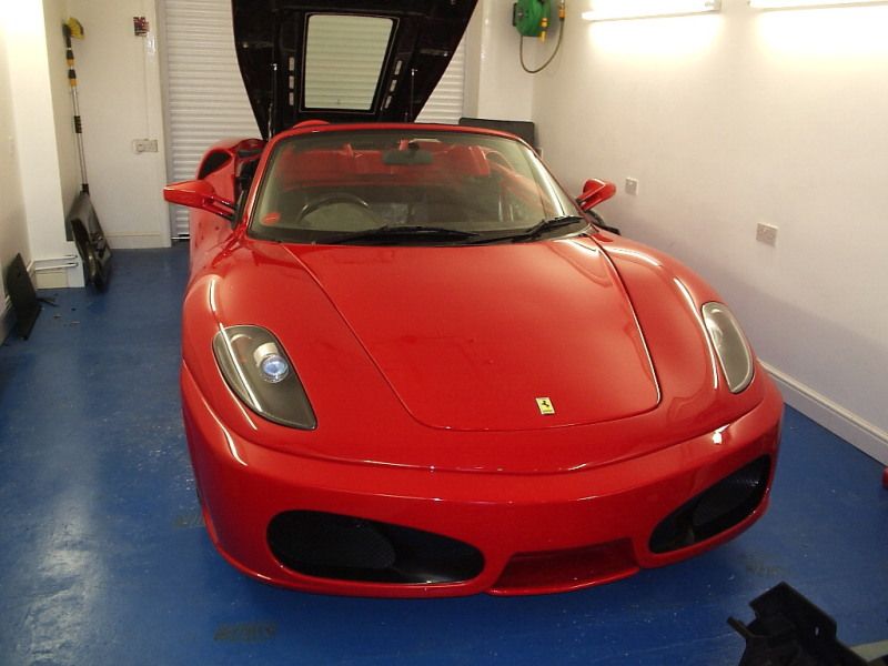

This will look the nuts when painted etc.........
Gratuituos shot showing the OE Bonnet badge I won for £29!-:tooth:

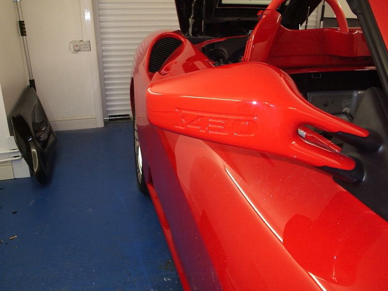

Fitted the mirrors Tonight and started to fit interior trim,so not a lot to show! LOL!
Mirrors done,using MR2 motors etc so still electrically adjusted.
Starting to look exciting now!
