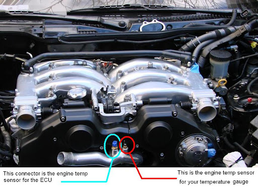

Temp sensor connection, you have been right in the area where it is and no oubt has a become a bad connection, this can be the direct cause of the cutting out and smell of fuel and when messing with the ptu connectioned also wiggles the temp connection and makes it good again so when restarting is ok.

Thanks Jeff, I'll have a look at the connection and just makesure its nice and tight
I assume this is what we're on about, the one on the left?
Yes the one on the left.
