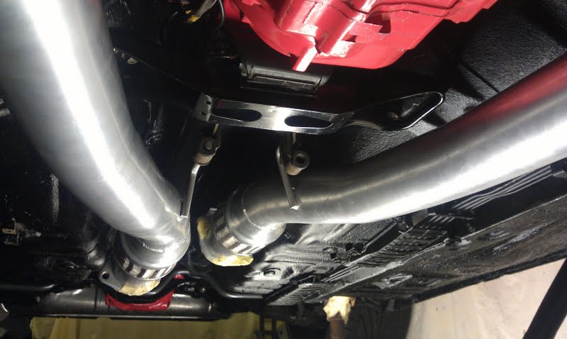

I started fitting the exhaust today but when i fitted the decats to the down pipes i noticed the drivers side pipe was sitting in a total different position to the other. It sits about 2 inches higher so its impossible to fit the pipe on to the gearbox exhaust bracket.
Has anyone else come across this problem? Im guessing im going to need to find someone with a pipe bender :angry:

Added pics
yeah i have the same problem, however i just did away with the gearbox brackets altogether fits on the rest aright. and isn't going anywhere,

Thanks Pete I'm hopefully coming towards the end of the build now and like you say there is no manual to building a modded zed. But id like at least 1 thing to go right first time now and then lol. I'm using Greg Dupree manifolds and decats just would of thought they would of been of better quality.
ive got a full japspeed turbo back system the front pipes and the mid box where a right handfull to pull together. i ently jacked up the cat section with a trolley jack and winched it in with some m10s
take some pics and contact SZ, I'm sure they'll advise. I'll be surprised if there's an issue with the parts
Ive taken some pics and have sent them to Gregs email i think. I hope ill hear from them soon. I cant see what ive done can be wrong but who knows lol
mine is out a bit too .... only happened when i fitted after market tubs and downpipes its only about 1.5" nothing bad as yours
is that the original exhaust flange on the downpipes ?
Mine didn't fit at all when I fitted my japspeed decats so I ground off the tabs on the gearbox hangers and ran without. The two sides of exhaust were level with each other though. I've since remade my own hangers and cut and rewelded flanges where needed and now my exhaust fits great without stress on any of it. Pretty much a completely custom exhaust now though!
I'm thinking of trying to get an exhaust company to bend the pipe a tad. The flanges are what came on the Sz super splits down pipes
