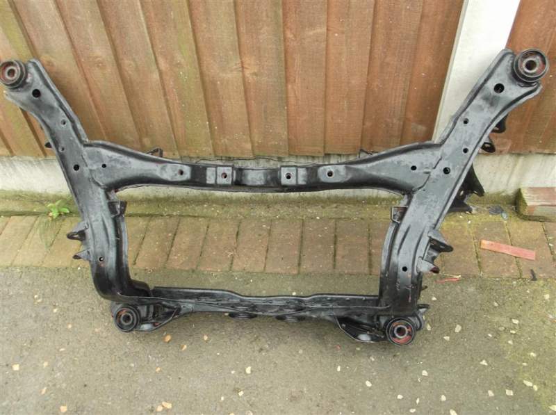

and now found rear subframe bushes dripping, stripped it off and heated up and knocked old ones out are stock bushes available or aftermarket,
what's your opinions on the ones to buy and where from.

Apparently Nissan don't supply the bushes separately, if you want to go down the oem route then it will mean a buying a new subframe assembly (sounds kinda expensive).
Energy suspension do poly bushes, they advise that the outer casing of the original bush is left in situ. Driftworks also do bushes which are supposed to be a direct fit, however they need packing spacers to maintain the correct subframe to chassis clearance and also spacing washers to pack out the centre sleeve.
Probably the easiest to fit will be the Energy Suspension ones, but if youve already cut out the old bushes that may not now be an option. One member on here has fitted the ES bushes after removing the originals and said there didnt seem to be any problem. I'm sure some of the other guy's will be able to clarify.

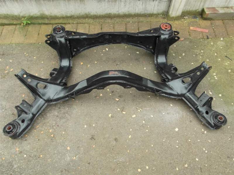

Cheers for the advice, so the other members have fitted es bushes with metal sleeves removed,
hope so or I'm in deep shite.
Anyone else got any advice please.
The sleeves had like rivets in them, take it the néw bushes come in 2 halfs.
Been searching a bit seems people are saying u remove sleeve to to fit energy suspension bushes and courtesy zed I think it's called sell set with sleves.
Another thing I'm worried about is I have fitted an na subframe and diff are the bushes the same na and tt.
Are the solid ones noisey, mines pretty much standard car and would rather keep has close to standard has possible.

Still lost on what I'm gonna do about these bushes, some say remove sleves and others keep them,
maybe it's easier to find an na subframe,
but found a place who shotblast and powder coat cheap, so really wanna make mine nice with new bushes.
The ones on cz seem to come with sleves, maybe I go for them.
