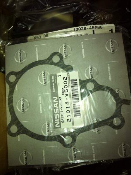

Hi do you guys use the standard Nissan paper gaskets for the water pump or the Red sealent stuff? Also what's the red sealent called that you use around the thermostat housing ect, can't for the life of me remember what it's called

Red Sealant there is no gasket for the water pump or main water housing units above the pump
I've bought a genuine nissan 64k timing belt kit with water pump ect and the water pump has come with a gasket
TBH, I tend to use silicone / sealants WITH gaskets. best thing is to see when you remove the old one if it has had any sealent applied, so you know if its necesarry.
HTH.
The old one had sealant on and no paper gasket, so not sure what to use as I know some people bin the paper type gaskets and just use silicone sealant
nothing wrong with the gasket m8 .. use it .. the set i got few weeks ago didn't come with any water gaskets it just recommended to use sealant instead
