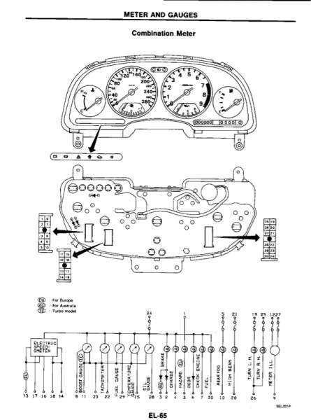

speedo pin out diagram
be aware that there are differences between the Series 1 and 2... (on the S2 the two plugs together on the left are horizontal and the wiring is slightly different, I think)
http://stadzport.com/FSM/EL_Electrical.pdf
page EL-41
Nice link, ill add that to my favs. I think Rolandas' is a series 1. Just use it as a guide and confirm each wire with a meter before you splice into the looms. The fuel level gauge (according to the manufacturer) will be within the operating range of the oem sender unit, but I would be cautious of your fuel levels until you can prove it lol! The fuel gauge reads from 1-99 as a % of full.
Everything should be pretty straight forward but there's a fair amount of splicing, can't wait to see them done, wish I had the time myself, I know I'll regret selling when I see them up and running! Good luck...
to connect everything is easy :) i just would like to know pin out of the actual speedo of them 4 screws that connects to pcb. But i will figure it out :)
