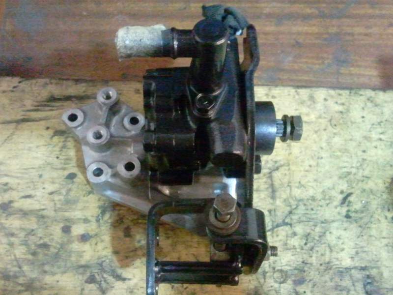

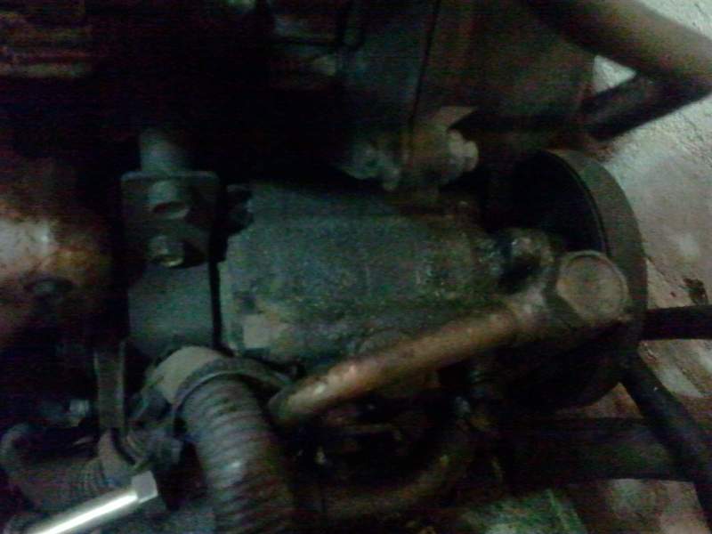

Mine part number is 49110-43P00, can anyone confirm if that is the later style pump that jap.slapper and Mikey are referring to?
Does anyone know which one I have? I've tried putting the number in google but it doesn't have pics or specify early or later style. It has 3 ridges on the pulley so need to get the right belt kit for my underdrive pulley
Which of the above pics does yours look like?, if its a fairly small pump with 3 ribs on the pulley i would say its a na pump or one off a tt with electric SuperHicas.
