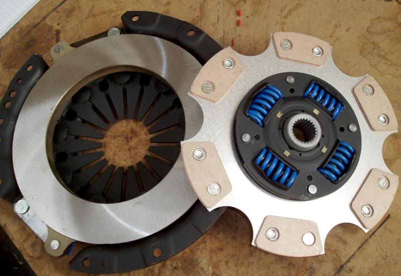

Ok the paddle numbers is important as it denotes what the clutch is going to do for the drivability and the performance, easy way to explain is the more paddles the smoother the drive take up is, the less paddles the higher the clamping force is.
So with this in mind understanding what the owner of the zed wants exactly is paramount, incedently neither will be overly heavy but a 4 paddle would be extream for road use and is the reserve of track day cars really, would not be nice in traffic etc.
The 6 paddle unit is entirely different with a nice smooth almost stock feel but with much higher clamping force and higher temperature material its ideal for upgrades, we do sell a good proportion of 5 paddle one`s though as its half way, between the two for this reason we fit these as a standard part of our manual conversions.
